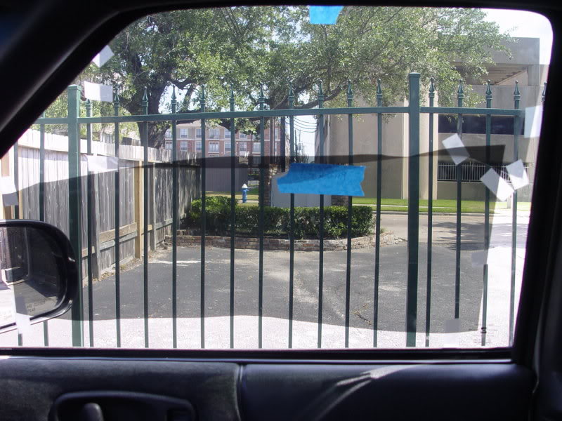

Black on black is tough here. I'm the same way except hardtop. Tint is your friend. Don't go for those $75 tint your car shops. They'll put junk tint on that gives about 15-20% heat rejection and will bubble up in no time (dyed tint = bad tint). Get a good high performance metalized or ceramic tint and you'll see 50-65% heat rejection.
To run some numbers, if it's 95° outside and 160° inside the car without tint (sitting in a hot parking lot), it would be 120° inside the car with tint. While that doesn't sound particularly cool, it makes a HUGE difference in comfort.
But even something as simple as replacing the leaking compressor will mean your car won't short cycle the A/C compressor and as a result you'll get some good cooling, rather than next to nothing.

Black car in Florida with permission to go dark tint and you're going to go with 35%? Why??? That's too light.
Here is the door window of our Blazer with a strip of 15% on the bottom and a strip of 35% on top. The 15% is much preferable as far as I'm concerned. Better heat rejection. Better glare rejection. And still very easy to see through.
15% is what comes stock on the back windows of SUV's and pick up trucks.
Now for the windshield, I would either do Air Blue 80 or else go with a 50% tint.
Here are some pictures of Air Blue 80.
http://ls1tech.com/forums/appearance...arge-pics.html
