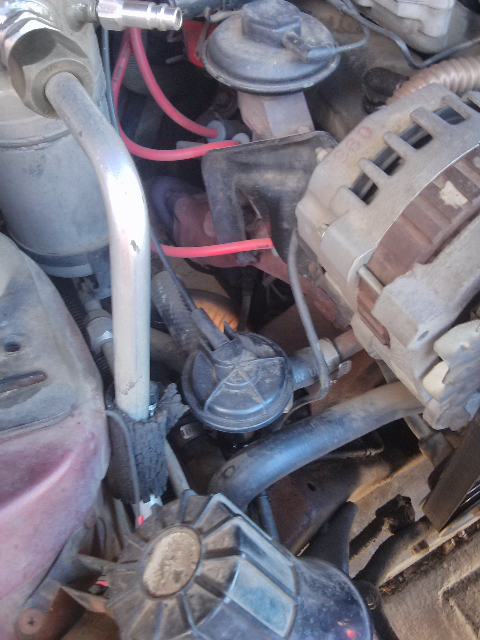

Hi everyone, long time lurker first time poster.
I'm having a strange issue in which the part you can see in the attached picture is leaking coolant. I'm brand new to cars in general and have an 88 2.8 v6 TBI. The part I'm referring to is the black cylindrical part in the center of the picture. It appears to be leaking from the bottom. There also appears to be a vacuum line attached to the top. Also is the part safe to pull from a junkyard or do I need to purchase a new one from a parts store? Thank you so much for your help, & I hope to one day be a valued contributor of this community once I learn a lot more.

That is your heater control valve. I don't know what to tell you... I have replaced 3 of them in the last year in my car. They seem to be a weak link. They cost about $16, and I bought mine at Advance... they guarantee it for a year, so I haven't had to keep paying, but it's a PITA to have to keep changing them and replacing lost coolant.

OK thank you for the info. Also is Dex Cool ok to run in our cars? I switched from the green stuff to dex cool on the recommendation of a guy at orilleys but since then I've had to replace my thermostat twice and my thermostat housing 3 times due to cracks/leaks.
