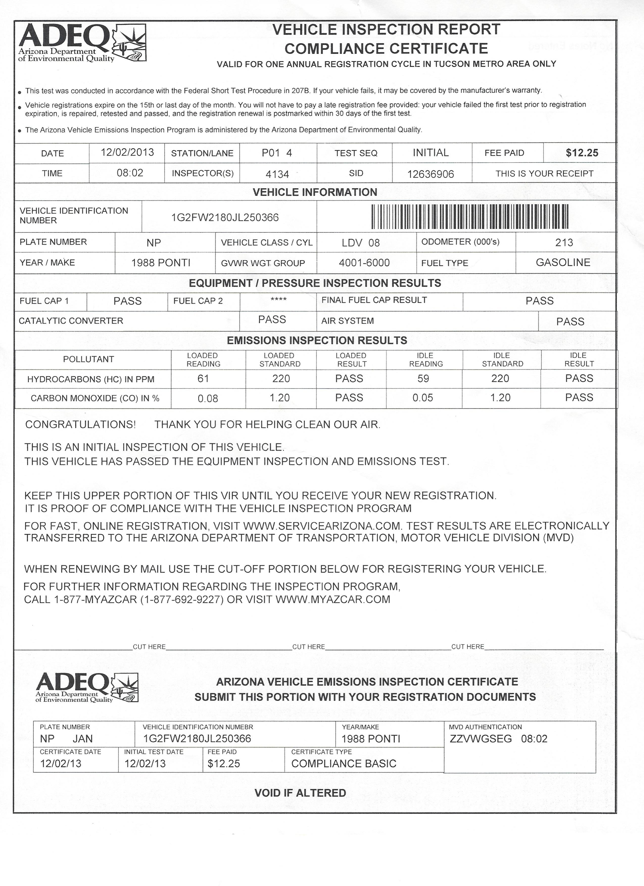

I looked back at my emissions reports from when I first got the car and the next year. During that year I had to replace the radiator, hoses and put a 180 tstat in (originally had 195 installd). Also, my distributor blew up, so I had a brand new ignition system, and there is a difference. With the new ignition system you would think the numbers would be better, but they are not.
2014s numbers are very close to 2013s. Where there was no significant changes to the engine.
Photobucket is being stupid right now so I attached the two emissions reports.
