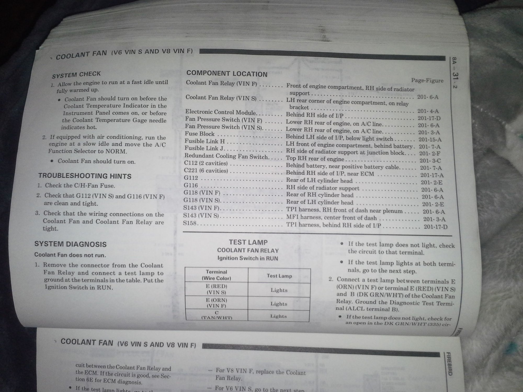

I am having this same exact problem. Before you go through the pain of that. The fan if electric has two relay switches. One is by the driver-side firewall the other is on the passenger side on the front. I have replaced the water-pump, thermostat, new anti freeze, and a relay switch. The problem according to the book I have an 86 service manual states the 6 bangers have a sencor that tells the fan to kick on. The 8 bangers use the ECM. I too have no heat and she looses power and doesnt seem to be performing well at times. This is the trouble shooting in the book Which I have yet to do myself. If these images dont work I will have them in my photo gallery.
Cooling fan 1
