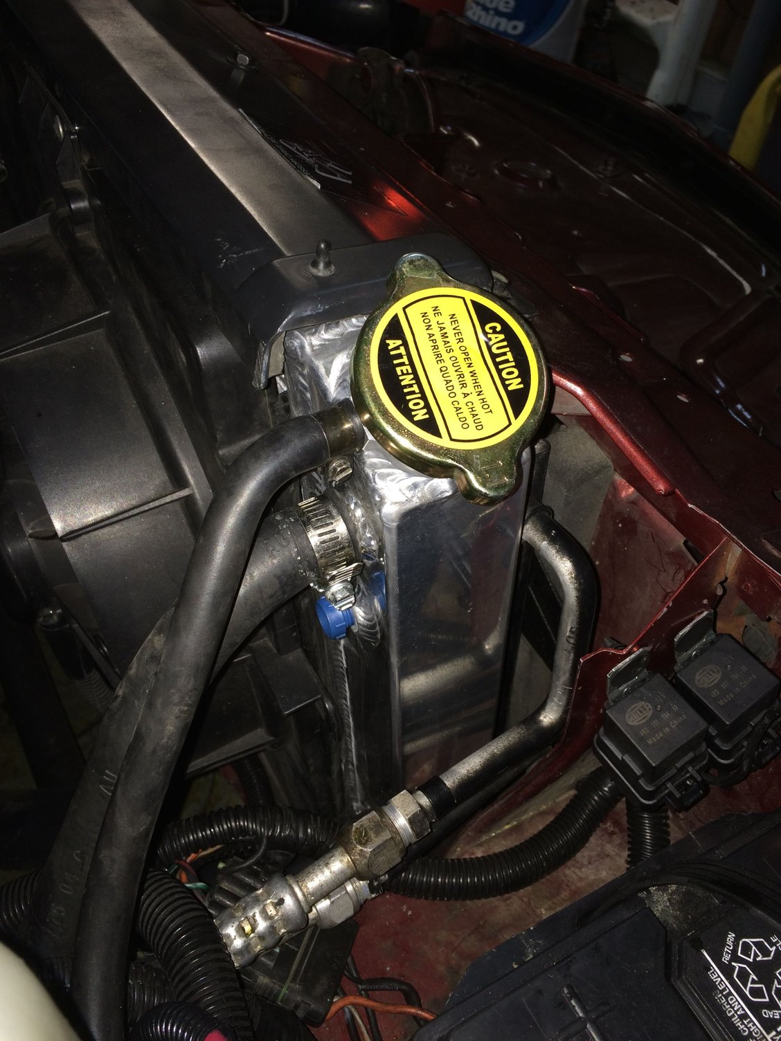

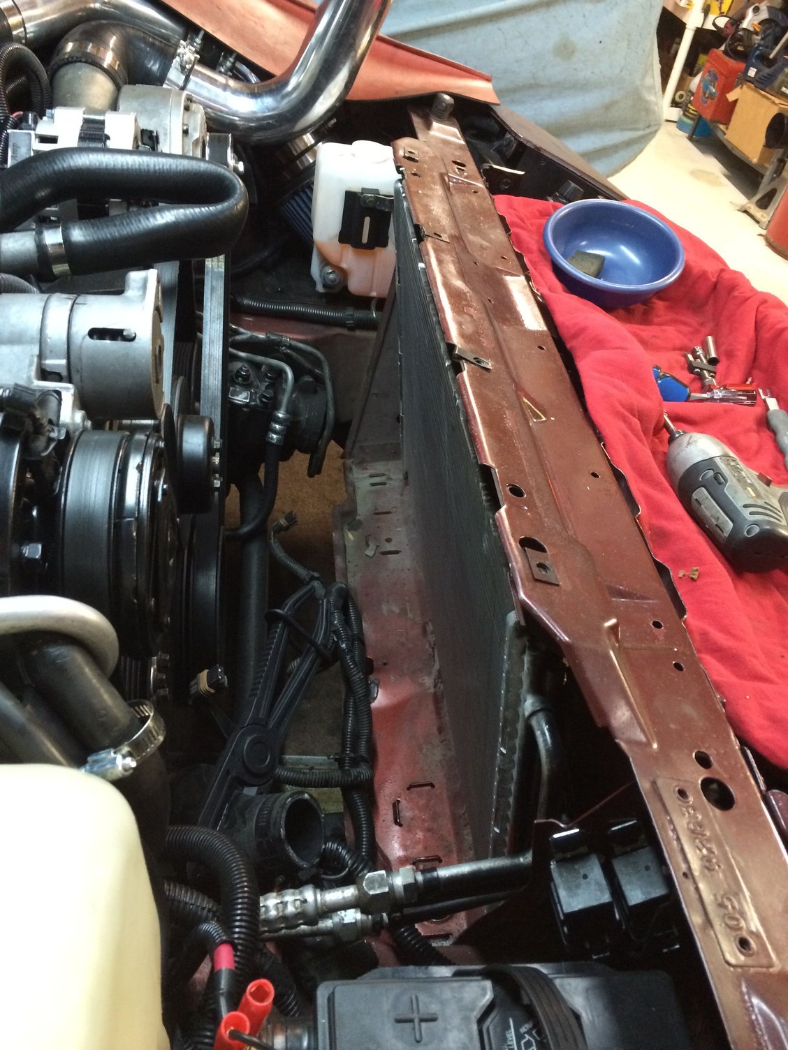

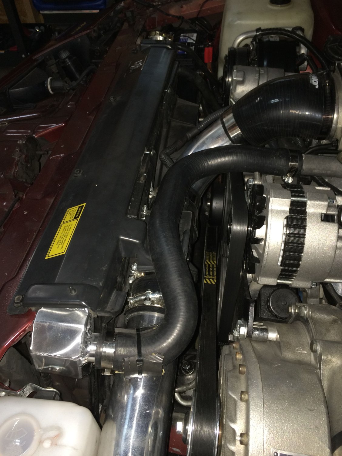

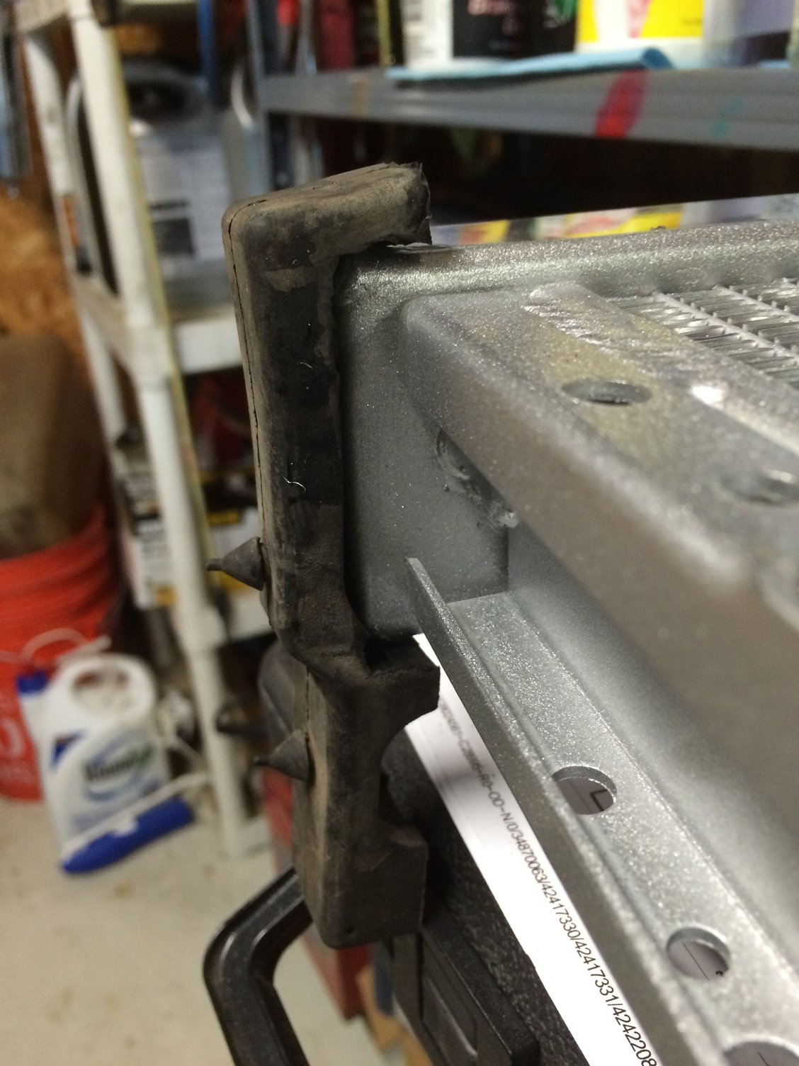

old radiator removed
trim the rubber mounts in the corners
outlet for heater hose was shorter than OE radiator. had to scoot the hose clamp to the end of the hose.
Fits really well. The bigger core pushed the fan motor to the p.s. pressure hose. Had to bend the hose slightly to get clearance.

The only thing i needed to do was cut the corners out of the upper and lower rubber mounts. I have 4th gen dual fans.

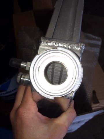

You know i'm not positive on the cooler threads because I have a T5. It did come with 1 3/4" screw in outlets to screw clamp on a trans hose. It sat in the stock position when installed. I was 90% happy with the install. I had to trim the upper and lower mounts so the radiator sat correctly.

When you cut the corners for your install, did you cut the inside or the outside, and was that on both the upper and lower mounts?

check out post #10 in this thread for a visual but yea, inner and outer, top and bottom

Yeah, I saw that but I figured that pre trimming, to me they didn't look like they'd been cut yet. I guess just a little trimming around the inner and outer radius to take up the larger area to fit in the saddle.
