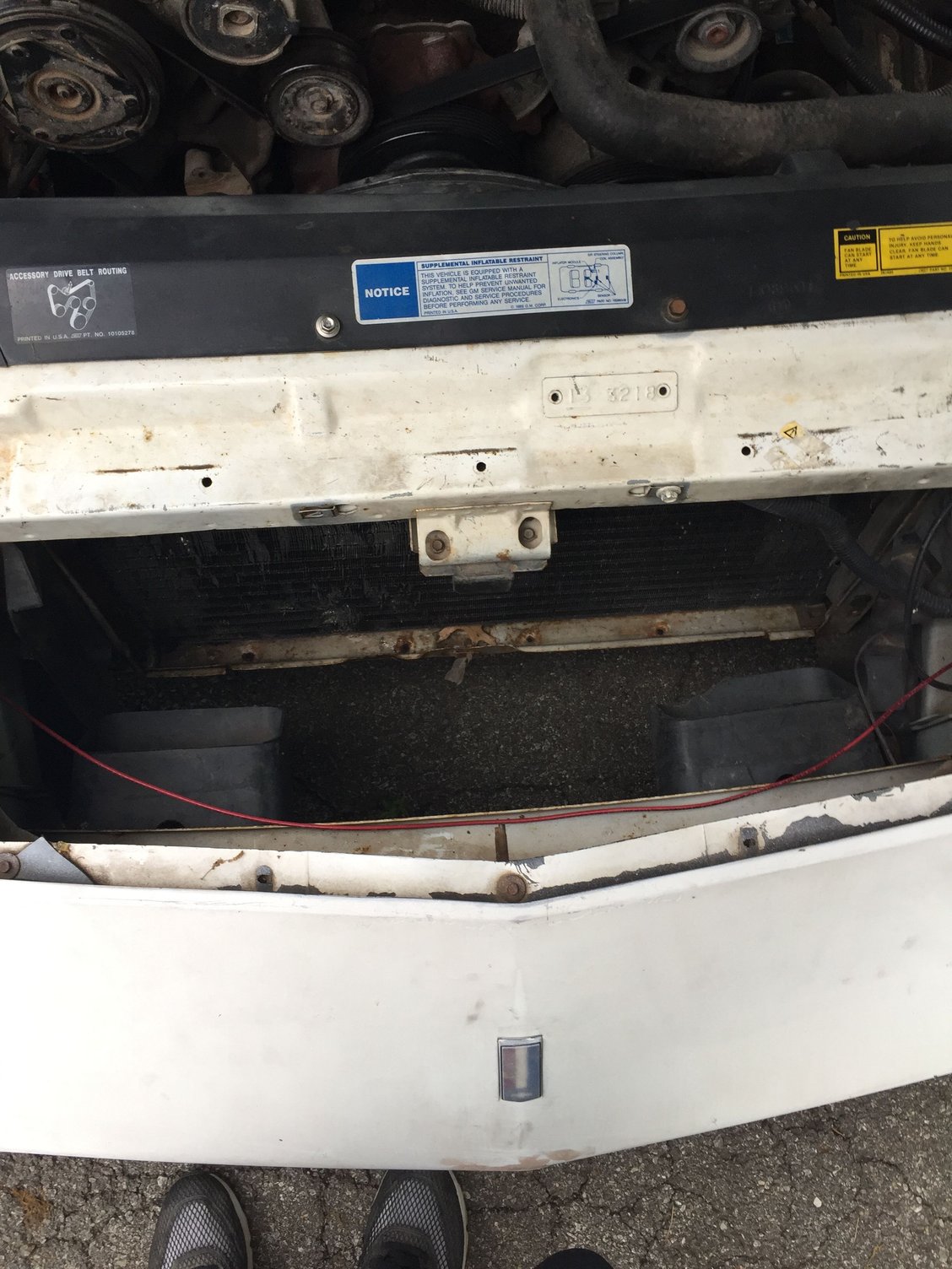

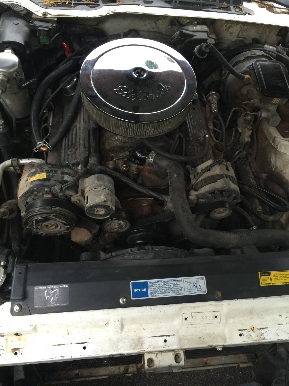

Did you replace the upper hose? Can you smell it overheating? Can you attach a picture of the lower deflectors and where the piece above is missing? What about the fan shroud, is it intact and fitted to radiator correctly? Maybe a bag or something flew up and covered the radiator due to the missing piece??

You seem to be missing your lower air dam (#18 in attached pic -008) and pretty much all the baffles to assure air is directed through the radiator.

Re: 91 RS 350 Overheating
I would hit up some junkyards and gather those missing pieces! They are crucial to ensuring proper cooling on these cars. Also, are you loosing any coolant where you have the heater bypassed?
One more thing. Give that poor thing some degreasing under the hood. Lol

This is the cover I was talking about. Is this necessary to have for cooling or is it just an accessory?

The cover is decoration and hides the baffles (ducting, whatever you want to call it) and the hood latch you don't have, too.
If the fan is pulling the paper as Ron stated, yes, it's fine.
The center air dam for a 'bird will technically work but, not for a camaro. The two extra parts are for the t/a / gta gfx pieces.
Camaro air dam... http://www.ebay.com/itm/GM-OEM-Air-D...dRdTvb&vxp=mtr
This is most of the crap your missing... http://www.ebay.com/itm/1985-92-Cama...BXHQfL&vxp=mtr

I'd start with all the correct duct work, maybe have it boiled locally. These radiators are bigger than 4th gens and when set up correctly work great in my experience.
Now your radiator does look rather thin.
Have you replaced your water pump? It's a cheap part, could be a part of your problem.

Water pump seems to be doing great, I don't think that's it

Still having issues. Brand new radiator. Could my fan not be spinning fast enough? Ways to check? I'm thinking about throwing dual fans on it...

driving down the highway the car should be pretty cool as its getting a ton of air. Thats how mine is now with my champion 3 core rad.
Its really cool when im driving at a decent speed, heats up when im going slower, ive got my dual fans on a switch under the dash and i flick them on when it get to 200
