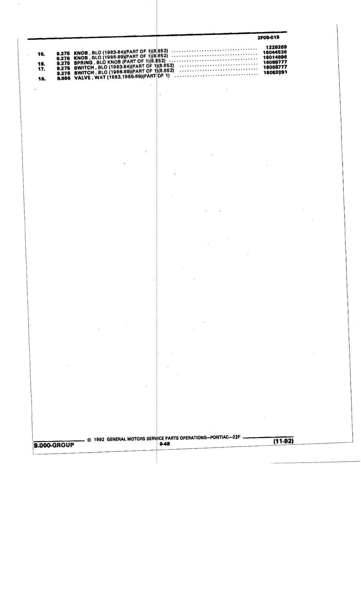

Thanks for your replies, guys. Just to confirm this is for a 84 Trans Am, we think the leak is from the HVAC vacuum line harness. Here is a photo of the part that needs replaced. Any help is appreciated.
Old Oct 4, 2017 | 10:52 AM
carbolicsoap's Avatar
Joined: Sep 2017
Posts: 3
Re: Problem with AC only working on windshield defrost
My mechanic has said it is the vacuum harness that connects to #5 on the diagram. Thanks.

5 and 18 in the diagram are both vacuum control valves. They're a stack of parts with a spring and a plastic push-in clip that holds it all together. It's pretty common for that clip to be missing one or both of the tangs that hold the valve together. The bolt fix linked above just replaces the plastic clip with a bolt.
The vacuum lines themselves usually aren't a problem, at least not the ones inside the car. The harness in post #5 is usually just pushed on with a couple tin push-nuts to keep it from coming off. Unless it's been damaged, it's unlikely to be the source of the leak.
