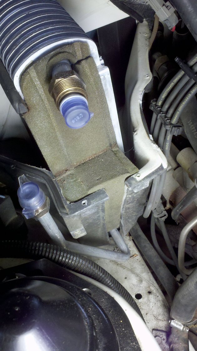

I have an '88 Trans Am w/ the 305. The air conditioning stopped working a few years ago. I actually have some of the old freon, so I was able to recharge it. But it lasted less than a year. Before I recharge it again, I'd like to figure out where the leak is and fix it if possible.
Also, I'm not opposed to upgrading the system to a modern setup, but from what I gather, that's an expensive and time-consuming job. Any1 have a parts list, costs, write-up, etc?

Look at your underhood noise blanket: if you see a streak of oil on it right above the compressor, it's the compressor seal.
Look at all the hose ends: factory hose becomes permeable and allows the system contents to pass into the hose material, and it then comes out the ends of the hose.
Look at the service valves: the valves themselves frequently leak and then rely on the cap O-ring to seal, which isn't what they're there for... those O-rings are only for keeping out dirt and water. If the valve leaks, the O-ring doesn't stand a chance of keeping the Freon (or oil) in.
Look at every fitting where a line bolts to something: there are 2 such places at the condenser, 1 at the evaporator, 1 at the accumulator, and 1 where the accum bolts to the evap. Plus of course the 2 seal things where the line assy bolts to the comp.
Finally, look closely at the comp itself: the comp itself is a cast aluminum body, and the entire outside of it is a big round sheet-metal band that slides over it and seals with 2 YUUUUUJJJJE O-rings. A terrible system, GUARANTEED to fail if the outside piece is distorted from, say, improper tightening technique at some point in its life. Also, the "stop" that limits how far it pushes onto the pump body, is a little metal tab with 2 spot welds, and those can crack and cause a leak.

So far the installation has been pretty straightforward, but I'm having a problem installing the evaporator. The instructions say to remove the old gasket from the old evaporator and put it on the new evap. The problem is that the old evap has a flat front edge, whereas the new part is slightly recessed at the top and bottom. As a result, there are gaps (big enough to stick my thumb in) at the top and bottom of the evap case. This means that the AC will be sucking in hot air from the engine compartment, which will severely reduce cooling performance. It also means that water and debris will enter the evap case, and it will be a great place for mice to nest during the winter. Any thoughts on how to address this? I tried calling Classic Auto Air and just ended up on hold until they kicked me off
Note gap where bottom tube exit case

Foam isn't going to stop mice, ever. Even sheet metal doesn't stop mice, so forget about that.
I am guessing you're concerned about the gap on the RH side of the picture? If so, then your worry is misplaced. Once you put the lid on you're good, you only need concern about the gap in the front, where to tub is in the lower part of the box and around the tubes. If you have larger gaps there, get some foam from a hardware store and cut to fit, or buy some window foam and stuff it in the hole. Also, you need to make sure there are no gaps at the top of bottom of the evaporator, so air cant get past without going through the cores. Some more foam will fix that, if necessary.
Functionally, 82-92 should all be pretty close, so I don't think you have a year application issue, just generic-ish parts to replace factory specific ones.

I am guessing you're concerned about the gap on the RH side of the picture? Also, you need to make sure there are no gaps at the top of bottom of the evaporator, so air cant get past without going through the cores. Some more foam will fix that, if necessary.
The kit states that the hoses are pre-fit. The piece they sent me isn't even close, and does not match the illustration of the parts in the kit. I figure I need about 15-18", and the piece they sent is 62"!

There isn't a lot of room between the stock evaporator and the bottom, and the factory only used a thin piece of foam glued inside the case. I wouldn't worry about putting foam in the bottom as the top, since you don't want the foam to hold water in the case. I would just go with the type with the adhesive strip for use around windows rather than the pipe stuff since that is more rigid, you want it to conform as much as possible
