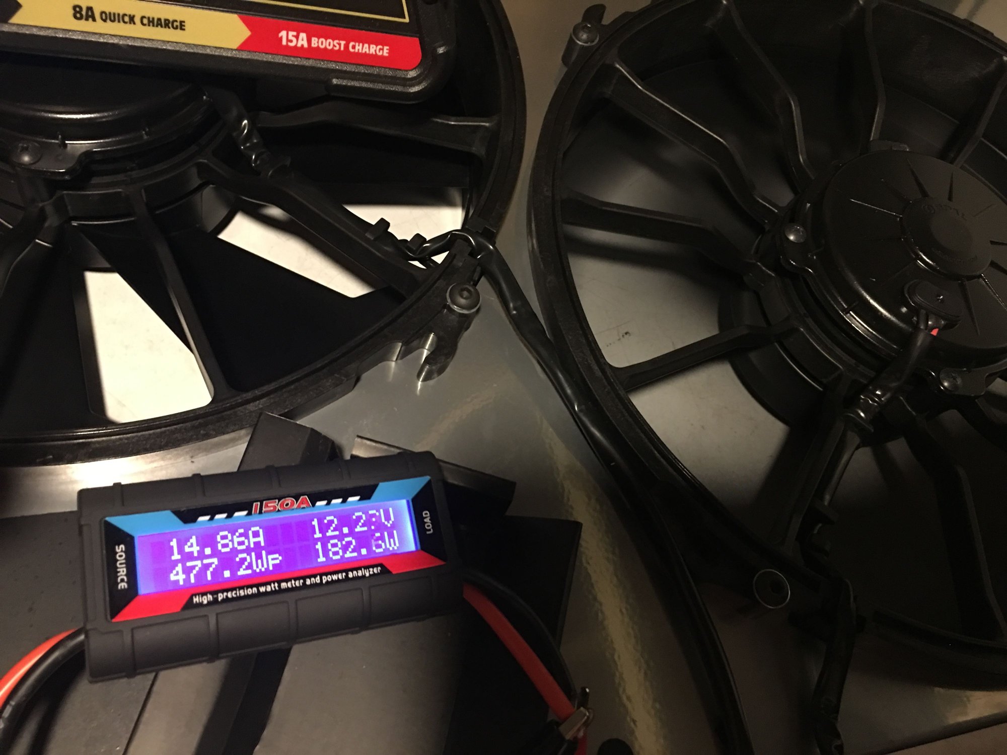

The dual fans I had were from a chevy traverse and they worked really good. Cut to fit the 27.5" core of a 31x19 rad perfectly. I thought they were pulling low amps (aka low CFM) like 8-9amps running. So I purchased the Derale dual fan setup (kit of shroud and dual SPAL fans) but for ***** and giggles I bought a dedicated AMP/Watt meter instead of using my regular HF meter to test for running amps. Got my AMP/Watt meter the same time my Derale's showed up so I tested both the traverse and Derale fans. Apparently the traverse fans were running 13amps running (high restriction on a flat surface) and the Derale's pulled 14.7amps running. So they Derale's pull a little more amps which is always good. The Derale shroud also has pressure relief vents which the stock shroud did not.

In the above pics the one of the meter shows ON ONE MOTOR is 14.86amps at 12.27v (this is a small lithium motorcycle battery with a 15amp charger on it to help with voltage drop). The interesting thing is that it calculates watt power and Watts and the Derale motors (they are SPAL and says it right on them motors are 300w motors but are only showing 182.6w being used while running. I never looking into what the WP (watt power) was being 477.2wp. The traverse fans used swept blades but the Derales/SPAL use the same cutting blades that the Mark IV fan uses and Ive always found them to be the better of the design.
EDIT!!!: Googles and found out that Wp is Watts Peak... so the motor peaked at 477.2 watts.
