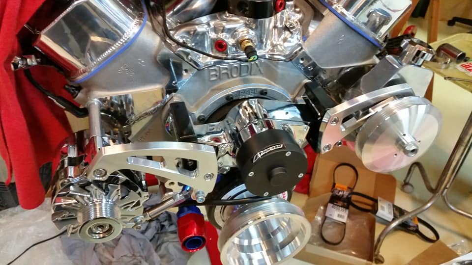

working on the 20an fittings

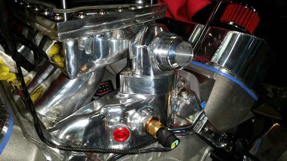

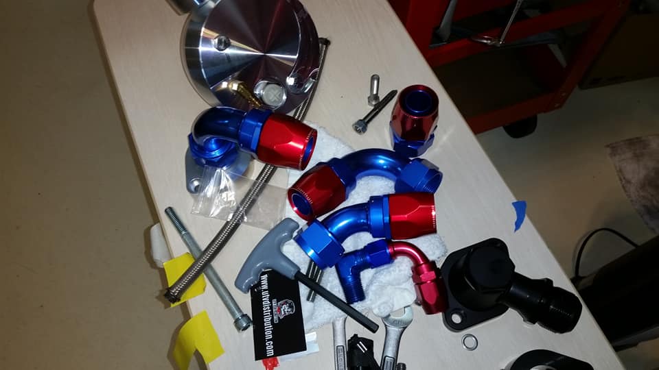

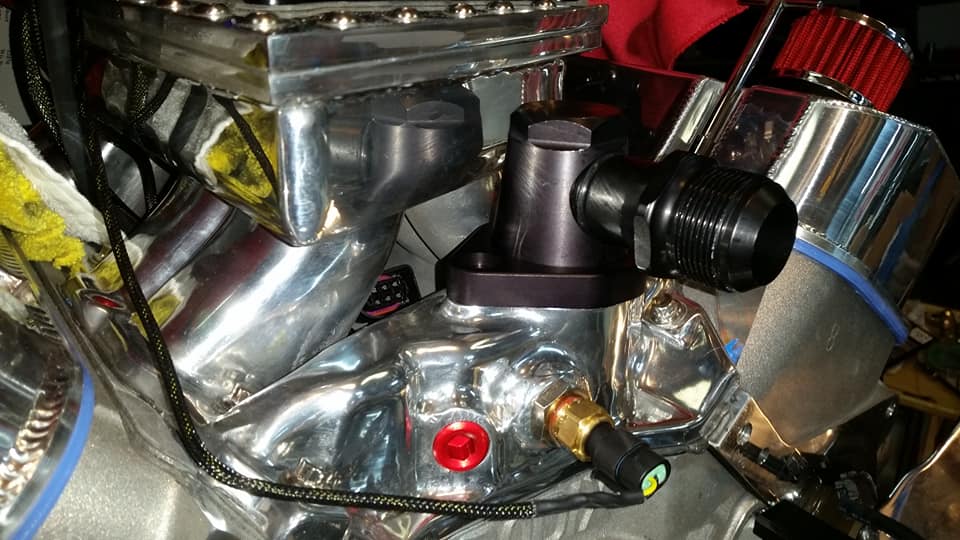

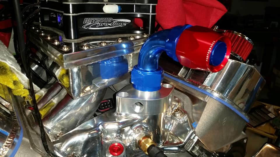

testing out a few fitting to get the placement I want.
thinking this unit is to tall..Moroso $38..but also have a 120deg fitting on the way..for a 2nd try
like this one..but its done only in black $40
this one I do like..metzer unit..and has a nice polished finish.. it's sold in 2 parts to a total of $110
the 20am fittings red and blue run about $38ea.. about half what summit sells them for..I could only get the 20am 120 deg from summit on sale for $75. IT pays to shop
think ill go with the metzer housing..

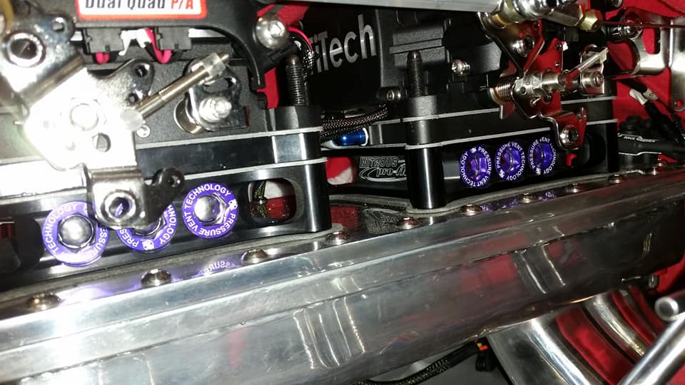

also added the blow out plates

I don't don't think there is going to be any Problems.. the type of water pump and what it flows.. then the temp of the T stat..and the size of Radiator..all play a part in the cooling..you have to remember a T stat only opens so wide..and can flow only so much..no mater the size of hose.its the choke point and its the temp at witch it opens..and the flow/speed of the pump to move it..in the time its open.. Iv never had a car with over heating problems..as like to keep them under 200deg..in the summer time.. and that's on the high side..
as for price..I try to stay with the name brand parts..some times it cost money when ya try to save money so.without looking back..just buy it and try it...its also about looks.. its got to look good..
this housing was the cheap cost.at $39.99
https://www.summitracing.com/parts/MOR-63476
this was the 2nd unit at $79.99
https://www.summitracing.com/parts/AAF-ALL30373
this was the metzer at over $80 then you had to buy the 2nd part to it..
https://www.summitracing.com/parts/MEZ-WN0020U
https://www.summitracing.com/parts/MEZ-WN0041U
the last hose end I tried out was a 120 deg..on sale it was only $75. but it was still to tall...
https://www.summitracing.com/parts/EAR-312020ERL
in the end I went with the metzer unit..with a 45deg 20an fitting.. and a 90 deg 20AN on the rad.. and sent the the rest back to summit..
