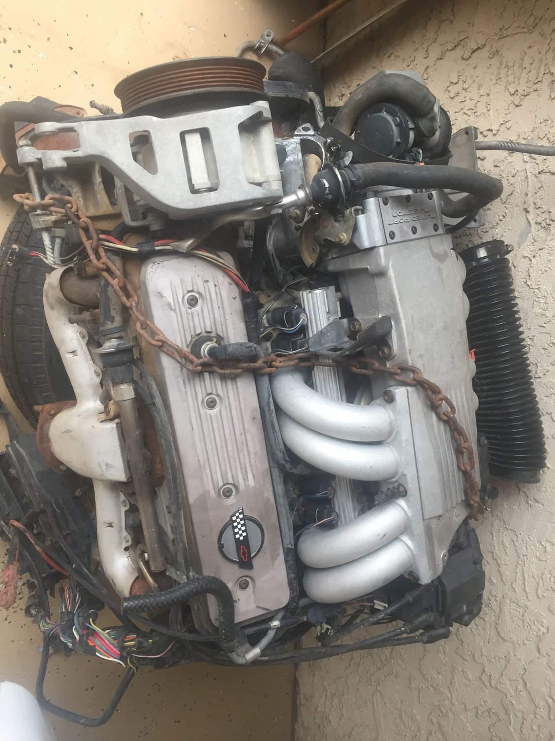

I actually got lucky and found a 1991 Corvette that was wrecked which only had 19k on the clock so I bought the engine and am going to take the next few weeks to swap it out. The car is a Gta convertible which I looked high and low for years to buy. I originally bought an LS2 however didn’t want to alter the car to that point so with a few little modifications I’ll sink the L98 in it and enjoy it the way it is
