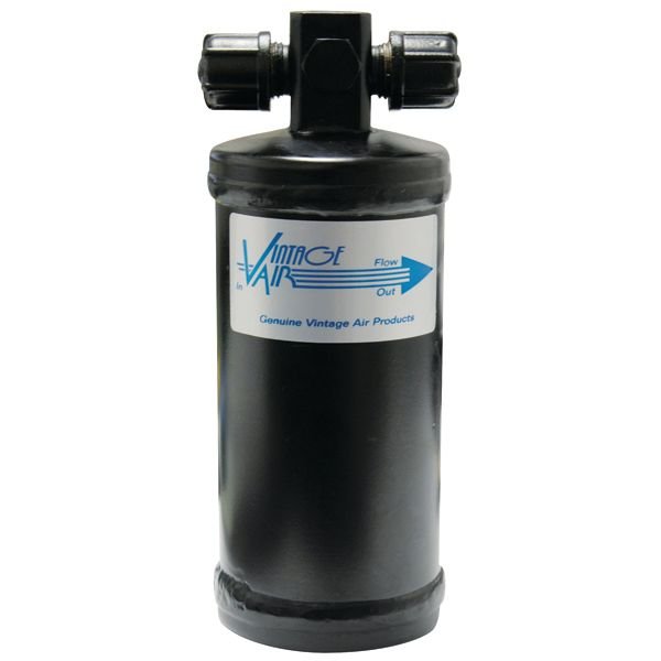

i was wondering if anyone knew of any smaller accumulators that would work? also can it be moved or angled?
going to attempt a turbo LS swap and try to keep a/c and heat. need as much room as possible.

Hi Mike , in theory there is no reason that the accumulator has to be mounted where it is on our cars , and as proof I offer up my 2003 Lincoln Towncar . The accumulator on my TC is right under the battery , just behind the passenger's side headlight . With the TC's accumulator being mounted so far away from the evaporator and working fine I'd say it's pretty much up to how much AC line plumbing fabrication you want to do and you could move it to wherever the available space is .

hmm good point. ill have to look where i got room once the motor is in.
This is also a thing on my Moms 2004 LeSabre (except the battery is under the back seat)

wonder if i can tuck it in the passenger fender

looks like vintage air has a smaller drier/ accumulator. this one measures in at 2.5" x 6" where as the oem one is 10 or 12 inches long i believe.
