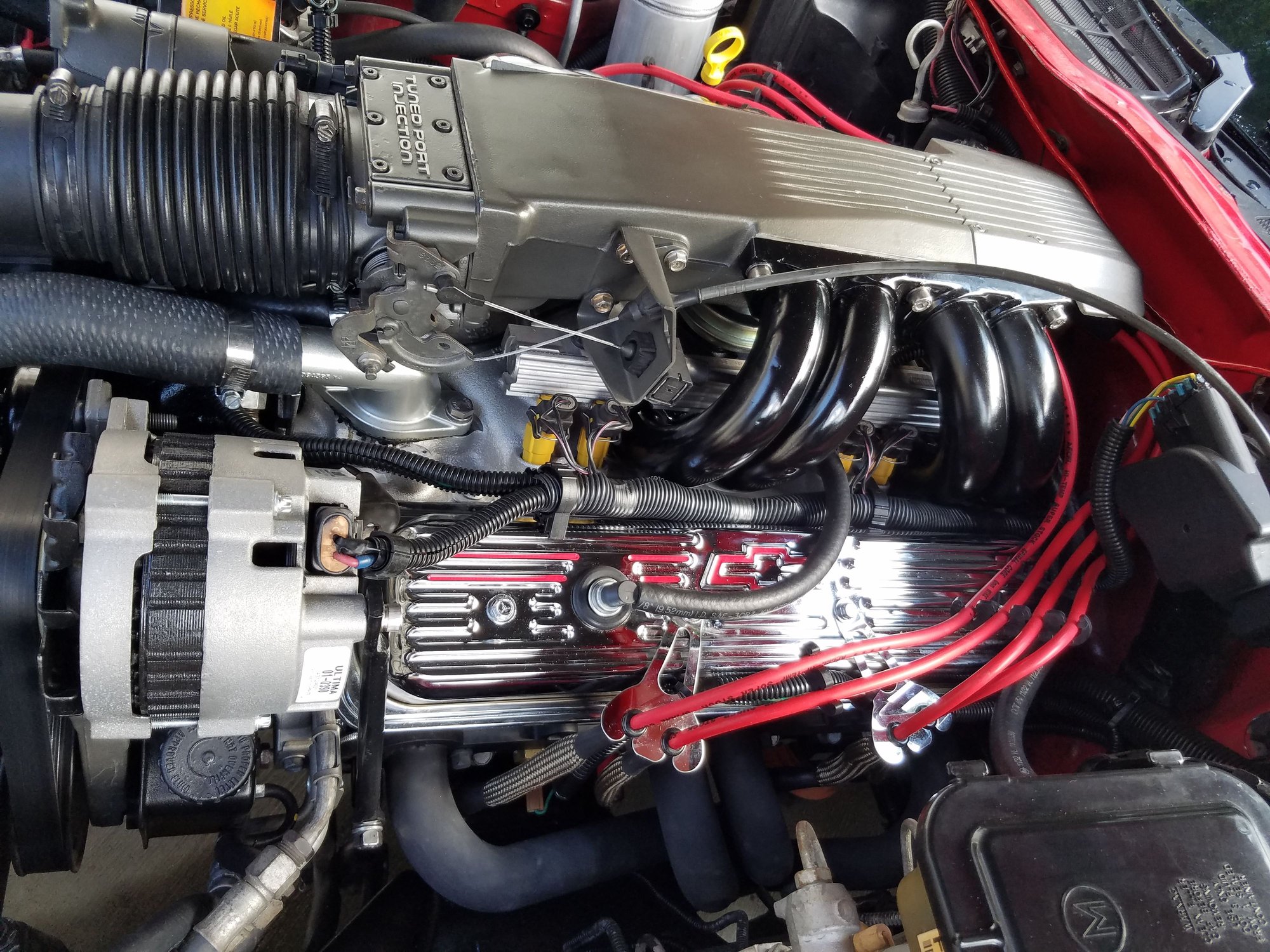

I have a 89 IROC. New GM engine 350 HO version, New everything on the engine, New Radiator, New hoses, new thermostat swapped 3 times. . Both my fans are new 12 inch electric fans. One comes on at 165 and the other is controlled by the computer. The air dam is in place.
My temp are hitting 230 and 240. I even checked it with my PC connected and the temp matched my digital temp gauge. I have read through a lot of the cooling threads this just makes no sense.
Im tired of messing with it geez. What does it take to cool these cars??
