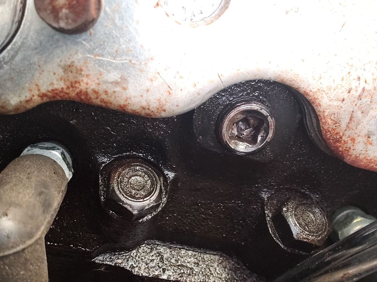

Do you have a picture of the plug?
Here is it! Looks like there another indent 45* to the initial socket?
Everything is still in place on my car so that spot you are referencing vinny R is probably occupied. Good idea though, sounds like it would give a very accurate reading.
On a related note, shot the intake above the thermostat yesterday. Discovered the thermostat is stuck shut! The temp gauge in the cluster appears accurate enough. Was reading ~200* when the gauge was at ~220* with the thermostat closed.
That's what I was thinking it may be. I've always used a ratchet an extension to remove them. And no need to go all the way down in there, that's just extra metal from forming the square opening part. Also, if you do have the "correct" tool for removal and its a bit loose, put some valve grinding compound on the tools flats to help get more grip.
That's good to hear. Hopefully the 11/32 socket I have will fit it now, going to try one more time this upcoming weekend. Will try tightening it a tiny bit to break it loose before attempting to back it out.
if you cant find anything to fit i use the end of an extension and if that doesnt fit i usually grind down the sides of the extenstion till it does lol that ALWAYS works good luck

Heat it up before trying to turn it.
Heat it, then put some penetrating oil around it.
Or as I had to, drill it and use a tap remover
