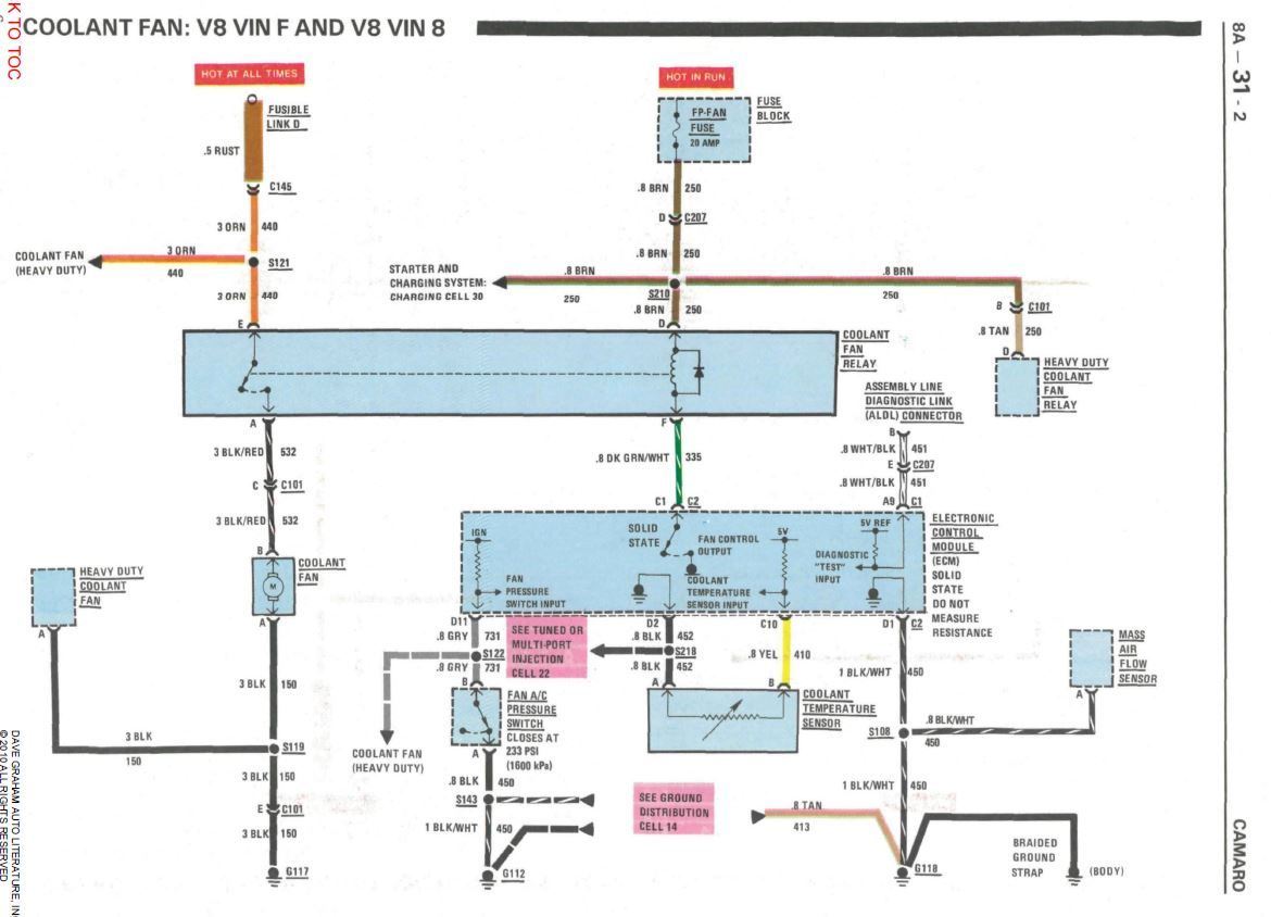

Test your fan and relay first by shorting the green-white wire to any ground point. If it comes on then you can manually control it there. Don't avoid it, it's really easy to do. I think all the wires/relays are right next to the battery.
You can also run your heater at full blast and it acts like a mini-radiator and fan. It can be surprisingly effective.

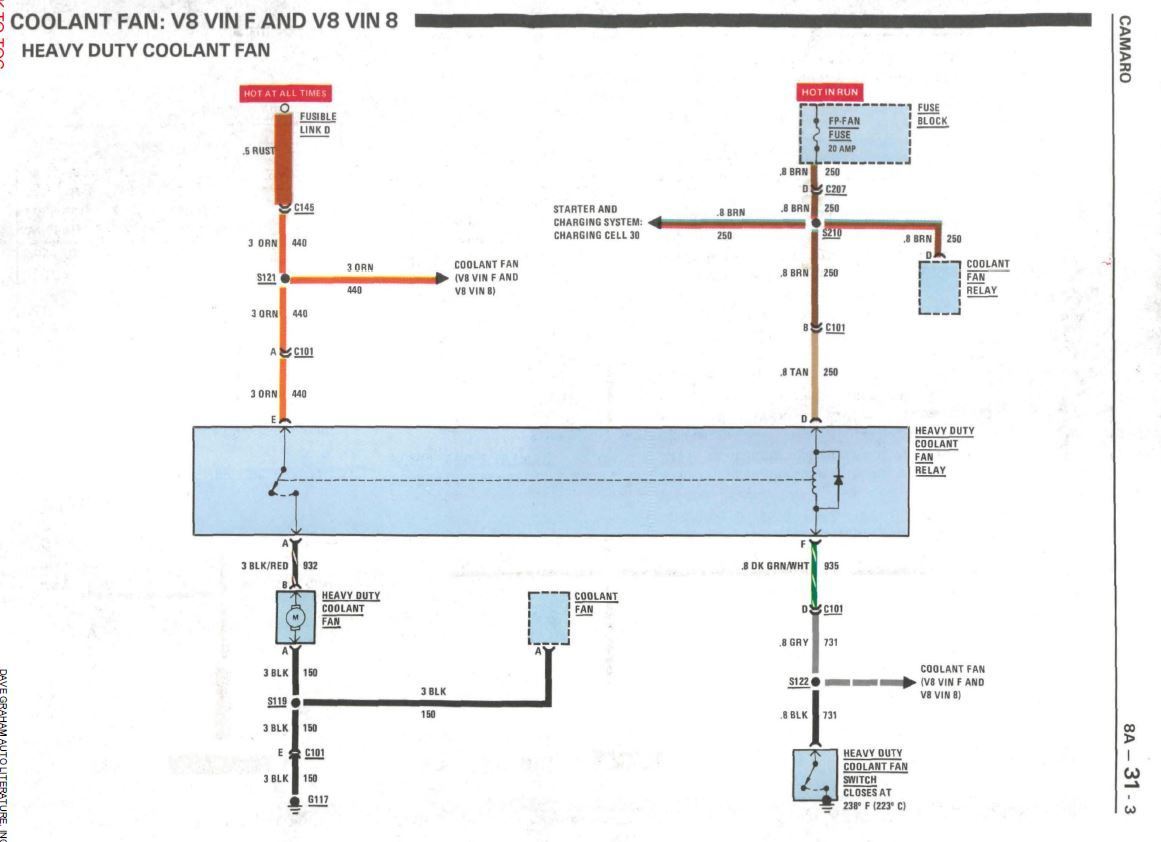

These are from a 1989 manual but yours should be similar if not the same.
