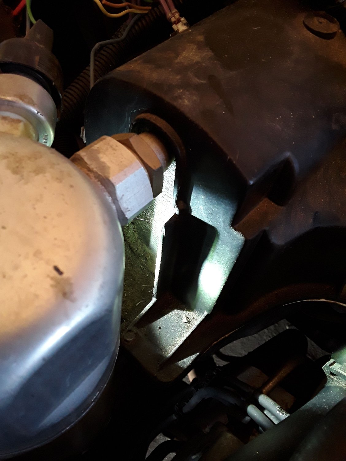

Mice got the best of my 92 Z28. As you can see in the pic they ate the top half of the foam seal on the evaporator core. Is there any way to buy or make a new seal? This is just one of my things that I need to figure out how to replace. Your help would be appreciated.

Any high density, closed cell, foam should work really but I am sure you could just get a foam from someone parting out a car and swap it

I bought rolls of generic foam seal from Lowes and resealed it. Cheap, works and looks good.

Thanks, we don't have Lowes but I'll check Home Depot. It doesn't have to be perfect. As this car will never be factory original. The mice did to much damage for that.
