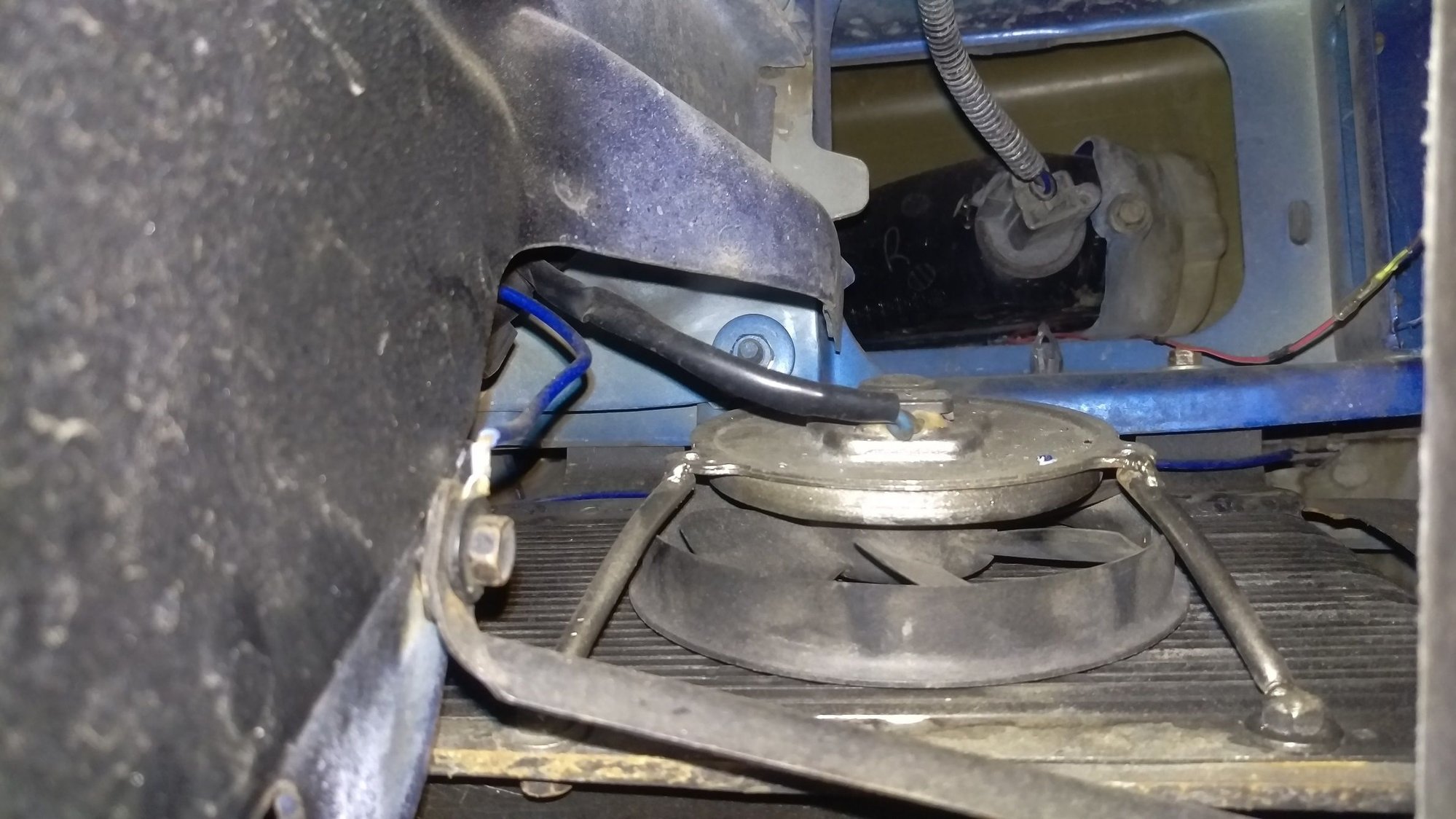

I kept my OE condenser, if you buy a direct replacement you should be ok. Im using the radiator trans cooler along with a small B&M trans cooler which is routed inline after the radiator. I also installed a small motorcycle cooling fan thats triggered by a temp sensor on the B&M part. I replaced my a/c components with the exception of the condenser. Probably shoulda done that one too.

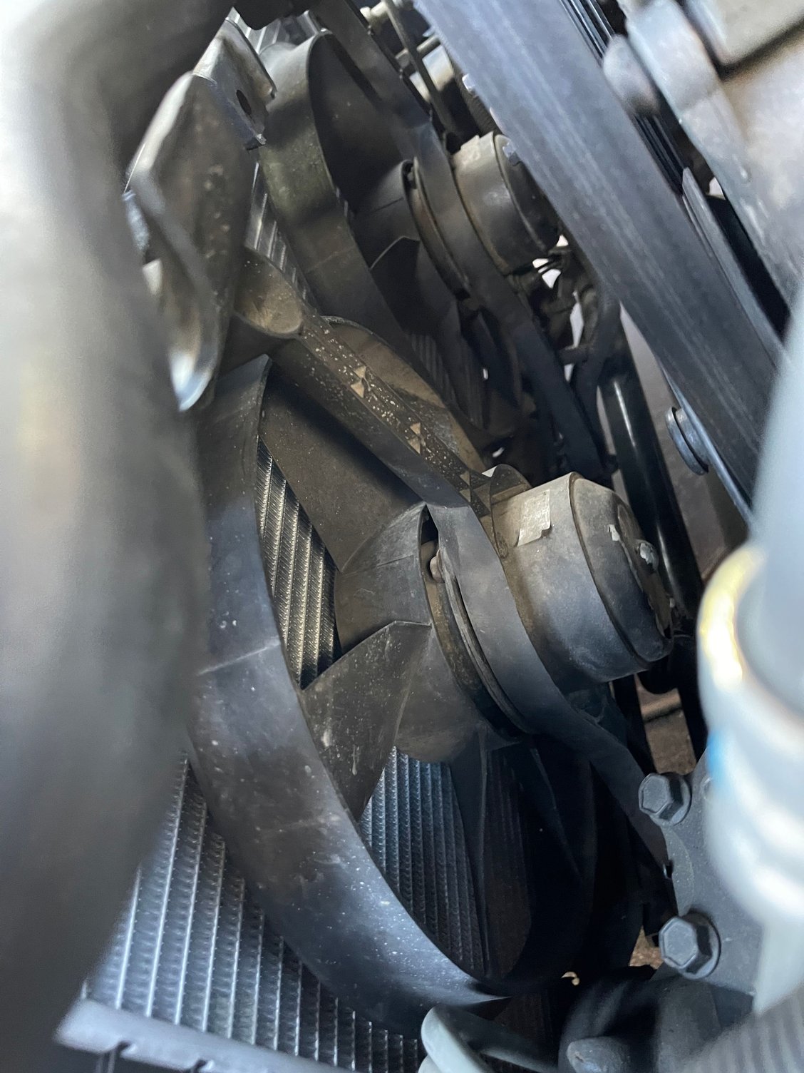

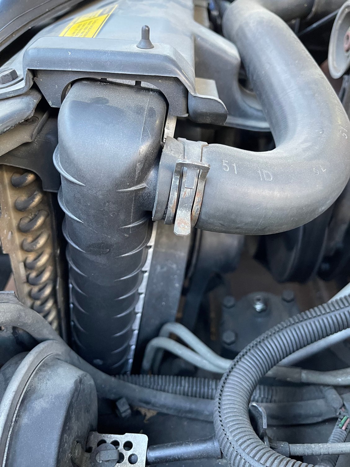

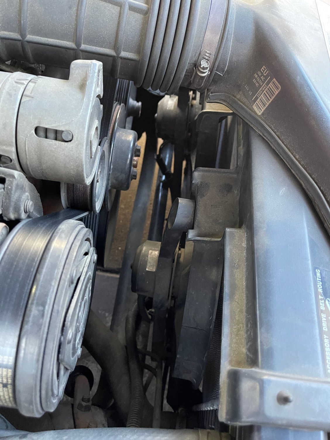

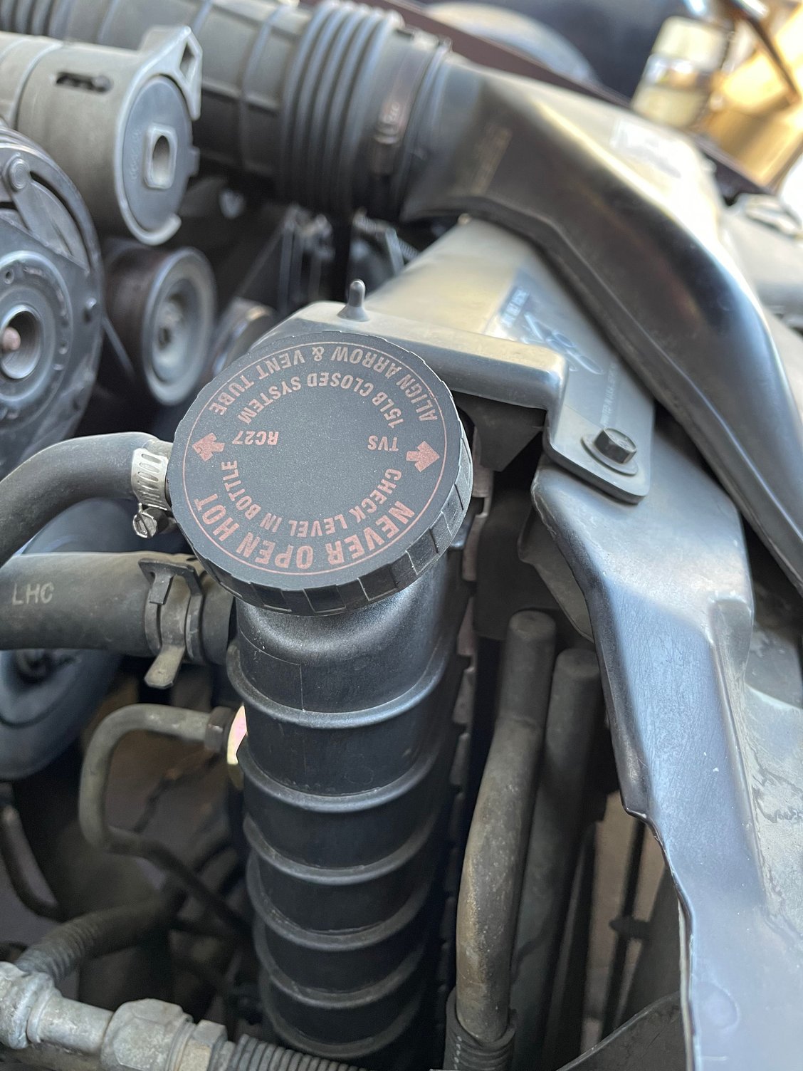

oh wow that sounds pretty neat on the motorcycle cooling fan for the trans cooler 😎 ill have to look into that when i get thisbplan situated. i took some pictures of what i have for the radiator as i still get lost when it comes to identifying certain things i havent touched. So bear with me lol.

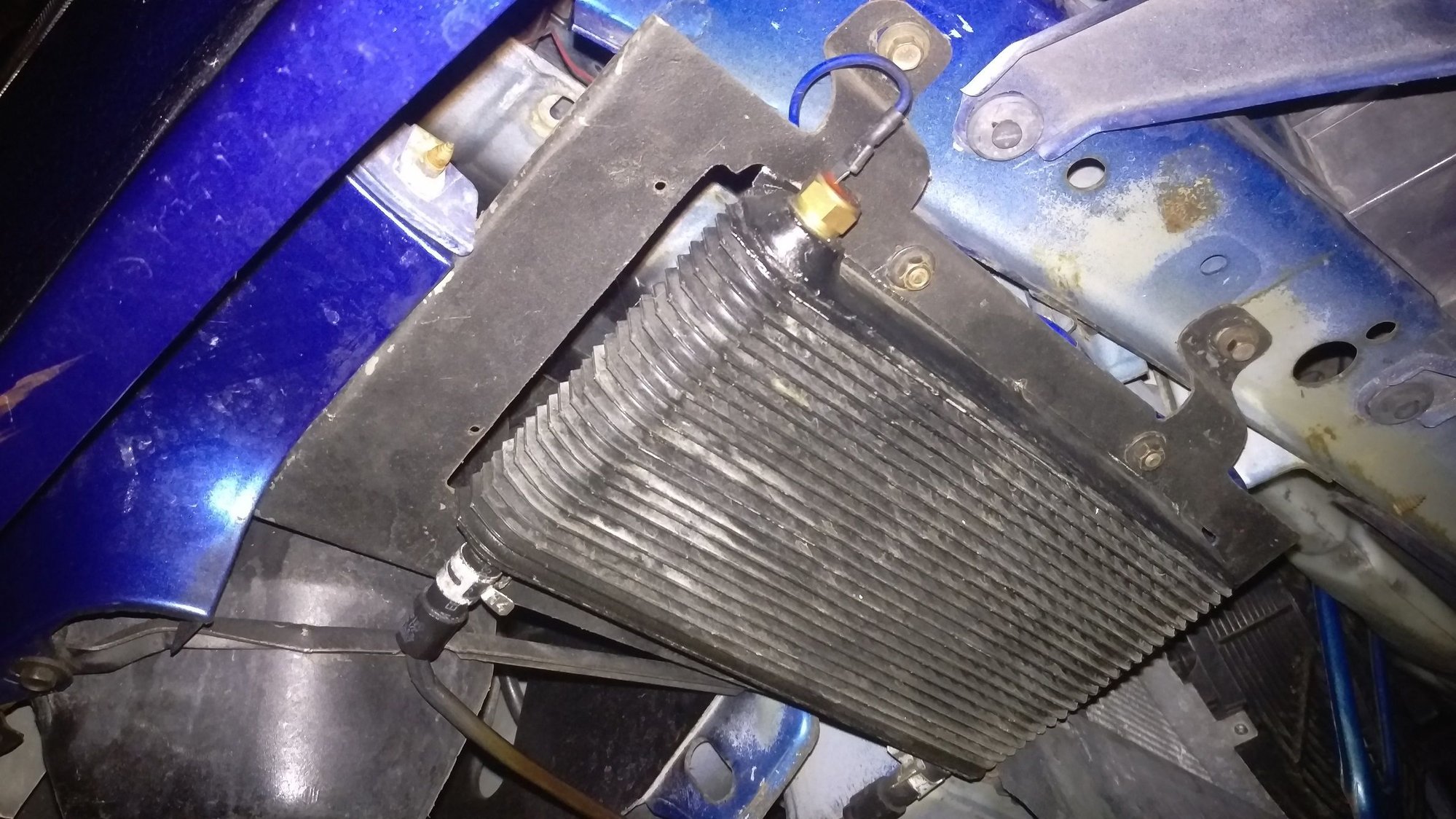

This is the isolator thats between the rad/cond.I trimmed it back to the yellow line. The red arrow points to the sheet metal part i trimmed at the blue line
This is the B&M fan, i think its from a R6, but they're all the same mostly.

did you make the brackets that hold up the cooler? it looks like its on the passenger side in the front? i see a turn signal housing

Yes, but its replicated from the stock plastic cover that was in that same spot prior.
