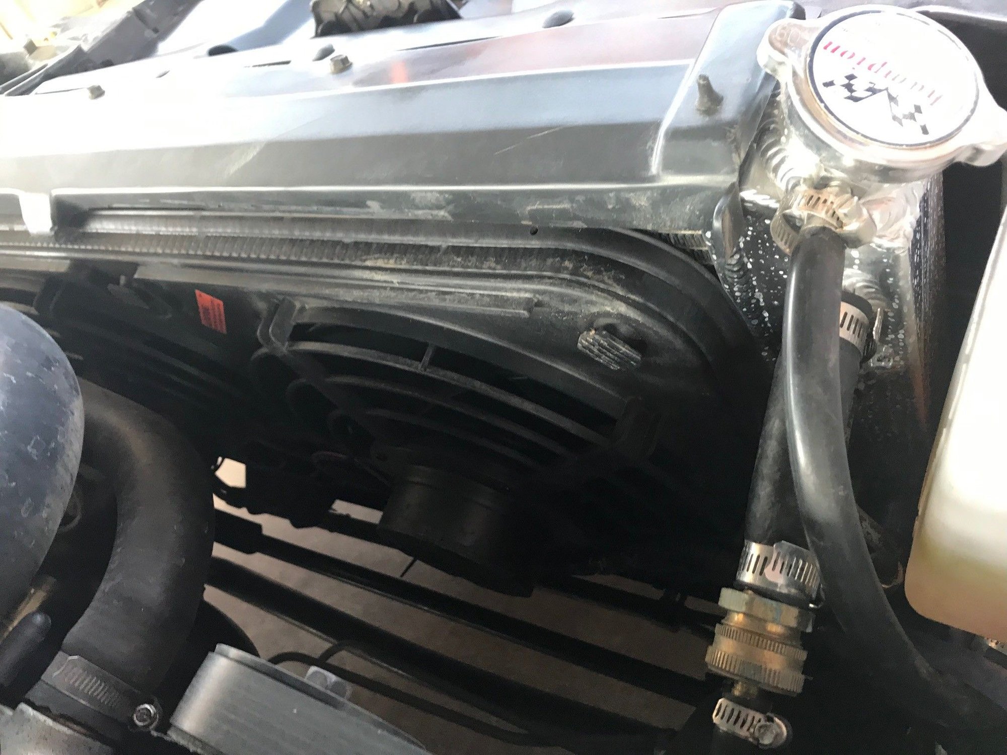

I also have a Champion American Eagle 2-row. I only needed to trim the bottom pads to accommodate the thicker radiator and just left out the top pads. The top of the radiator only touches the plastic hold down, which isn't particularly rigid, so it's no big deal. You could probably just use some kind of substitute for the bottom and keep your original pads, like split heater hose. But I don't know if the mechanical fan setup would cause issues though since the all aluminum radiators are thicker. Might be better off with getting a standard replacement?
I didn't really see a huge difference from a stock replacement radiator at the Champion 2 row, but it definitely did cool a little better. In retrospect, I should have added more fan CFM as the aftermarket replacement Taurus fan I have doesn't seem to flow as much as I thought. The OEM Ford ones seem much better from what I've read.
I wonder what operating temps that fan clutch is set up for. I know the later ones have pretty high "normal" temps. GM set them up for operating between 195-235ish degrees, with 220 being "normal". The stock electric fan triggers (both the cylinder head switches and the ECM) are at fairly high temps which is why they run hot. However, the stock electric fans are horrific as they have no shroud, but apparently they suffice with a stock engine for stock temps. Not sure how well the mechanical fan setup worked in these cars. At least it looks like they got a shroud?
One thing that helped my car quite a bit, both engine cooling and AC effectiveness, was to take some foam and fill the gaps between the radiator and core support so that the air has no choice but to pass through the condenser and radiator. This also stops it from recirculating as much "used" hot air from the engine bay. I also filled the gap between the radiator and condenser to further help the AC. I used the large square stuff meant to fill the gaps around a through-wall home AC. Didn't fill the bottom though because I didn't want it to hold water. I wonder if there are some excessive air gaps between the shroud and radiator on your setup? That would cause the fan to circulate engine bay air instead of only pulling new air through the radiator.
