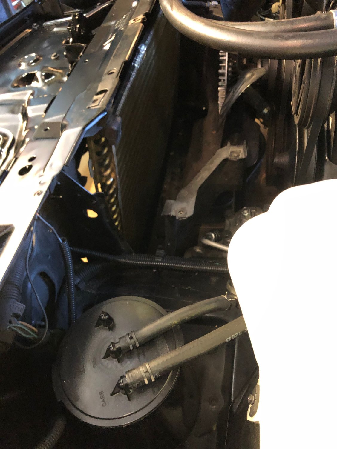

Welp today this happened to me while i was pulling up to the drive thru at In and Out restaurant. Heard a pop, steam coming from the hood, immediately parked , ran back to the window and saw all the coolant all over the ground . It's home now, so i'm looking at two Radiator upgrades between Be Cool and Wizard.
https://www.becool.com/product/radia...-trans-be-cool and https://wizardcooling.com/1982-1992-...s-fan-package/ are the two . Anyone have insight on either of these two kits? My car is stock 5.0 automatic. The Wizard one says it doesnt come with the trans cooler, but priced the same as the Be Cool Kit. Insight is appreciated on whether i will experience issues with these aluminum radiators or stick to a Oreilly/Autozone/etc kind of radiator.
