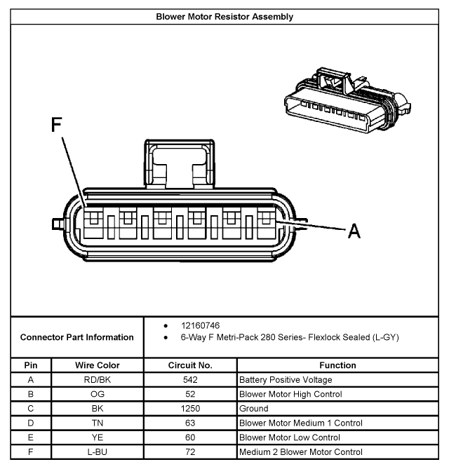

I used a 99 Tahoe replacement front blower motor on both of my G20 vans. The G20s used the same blower as a F-car with ac. The Tahoe blower has a rubber seal, rubber isolators for mounting and the wheel is the same size as the older ac gm blower. Has a more powerful motor. Vans definitely blew a lot harder after the swap but be careful of old wiring.
Before my laptop battery rudely went dead, I was about to describe what needs to be done to the wiring. After swapping blowers, it started to melt the old high blower relay connector on the old 1983. I converted both of the G20s over to an Express van blower resistor with a built-in high blower relay. I also rewired both the power and ground to the blower motor. The high blower wire on a typical GM is fairly undersized if you plan to run high fan speed for very long. In fact, I recommend no more than 15 minutes of high fan speed operation if the power feed is unmodified. Here in Texas on a hot day that is not an option. I grabbed an Express van blower resistor and matching connector. I removed the old resistor and old high blower relay. I traced the wiring back. There are 4 switched settings, each has its own power wire for the corresponding speed. On the lower 3 speeds the dash switch powers the blower motor through the resistor for the speed in use. On high speed the switch activates the high blower relay. The express van resistor portion that pokes into the ac housing is a little larger than the typical older style wire resistor. I had to open the case up slightly to match. Since the early express van used a resistor that was smaller, the supplier was thoughtful enough to include a templet to trim the housing. I trimmed the housing and mounted the resistor, then ran the 2 wires from the blower resistor toward the blower motor. I cut the connector off the express van resistor and installed two weatherproof spade connectors. I then ran the large gauge positive wire to a 40amp circuit breaker that I connected to a new junction block that was fed from both the battery and the alternator through fusible links. I had previously replaced the junction block because they had a habit of melting when the alternator was replaced with a higher amperage unit. The heavy gauge ground wire was connected directly to the alternator mounting bracket given its proximity. Now for the funny part, between 1983 and the 2006 Express wiring diagram, they used the same color wires for each speed. I have since found its almost universal for GM to use those colors. In a nutshell all 4 wires go to the matching colors on the blower resistor connector. The end result of that work is the blower motor now receives near full system voltage on high fan speed and blows even more air. The old blower was half of the equation, the wiring was the second yet equal half. At 25 amps with ~10 ft of wire in the high blower circuit (remember it includes the ground side as well) it required at least 10ga (I used 8ga) power and ground wires. With the system at 14.5 volts the blower motor is receiving 14.3 volts on high fan speed. That is as good as it is going to get and far better than it was.
THANK YOU for posting this and verifying my thoughts!
I asked a question on here about using the Express Van relay/ resistor as a way to update and clean up the HVAC wiring, and people pretty much said I was stupid for trying, because the factory setup worked just fine.

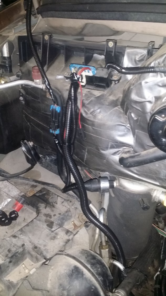

The Express van one works better than the OE ones. I burned several of the stock high blower relays out on my old 83 and that was with the stock blower motor. After rewiring the blower the motor had near full system voltage. The Express van one looks cleaner and handles higher amperage since it too has a more powerful motor. The Express van front blower draws nearly 30 amps at startup.
As installed in my 97 Express.
