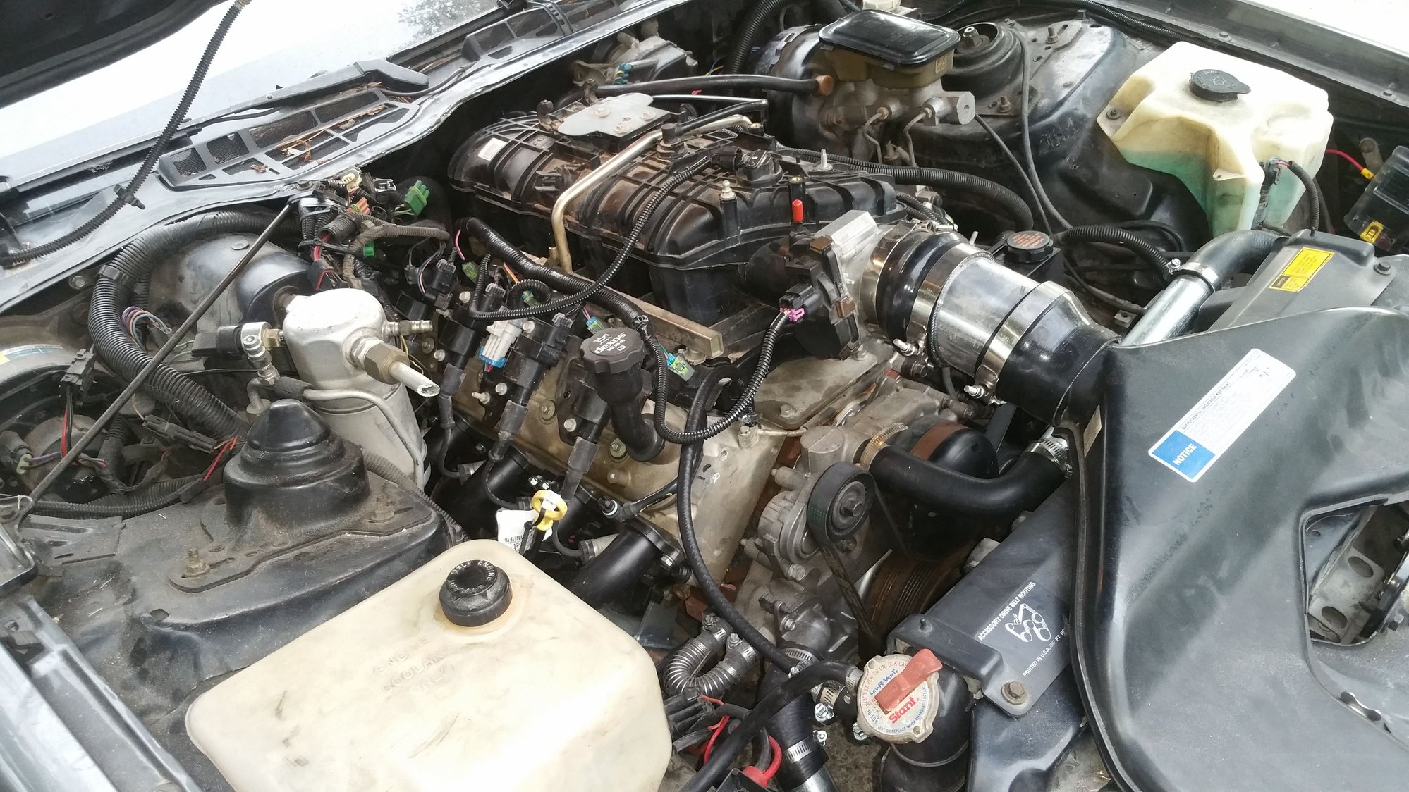

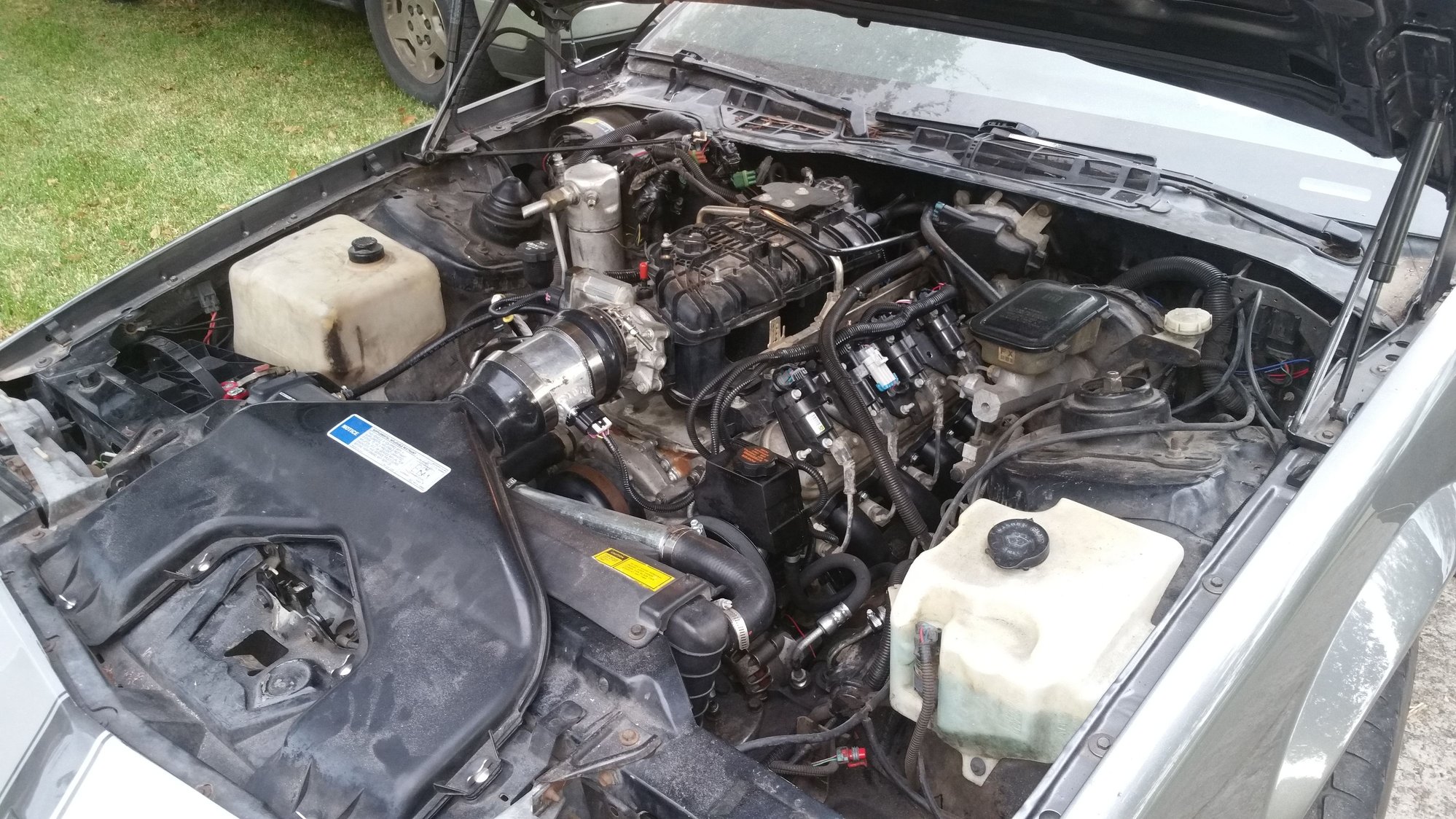

Will it work or should I get a upgraded cold case all aluminum radiator? The car is running warm with both fans on all the time.225/230
stock seems kinda small.
