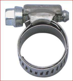

Re: Coolant leak at Firewall (Not heater core) 85 Z28 383stroker
Did you reuse the old hose?
Use this type of hose clamp.
You can clearly see why from the pic.
