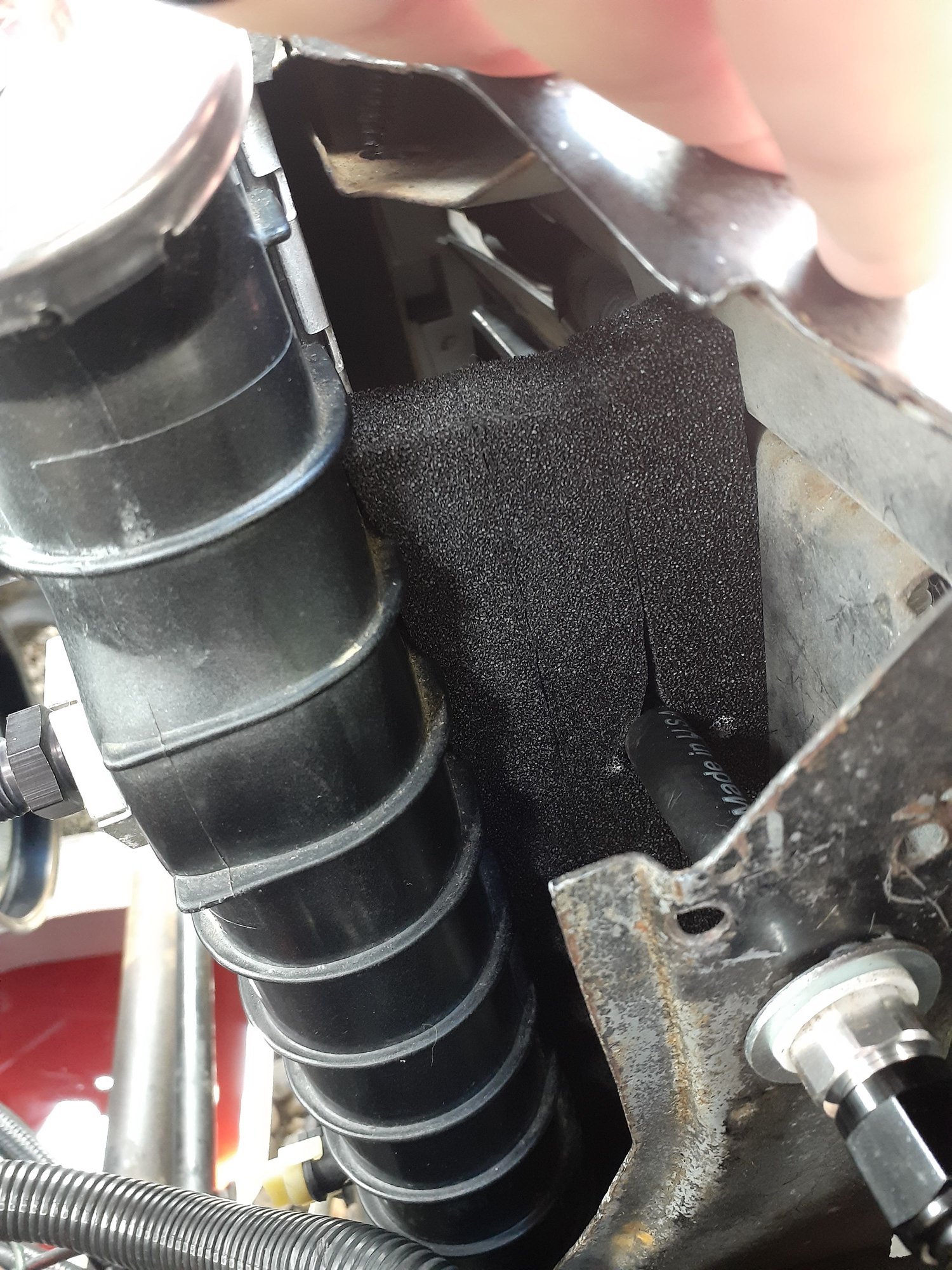

Go to a hardware store and get a roll of 1"x1" expanding garage door seal tape. I got mine at home depot, they have adhesive already applied and you can keep layering until you fill the gap. This is what I did, and my car stays very cool:

[QUOTE=Komet;6476048]Go to a hardware store and get a roll of 1"x1" expanding garage door seal tape. I got mine at home depot, they have adhesive already applied and you can keep layering until you fill the gap. This is what I did, and my car stays very cool:
Was it over heating before you added the foam? What do you have for fans? OE?

No, but I had the ac condenser with its foam strips blocking that channel before, so it's doing the same job minus the condenser. I have the stock dual electric fans. Air follows the path of least resistance so if it's easier to go around the radiator than through it, it's gonna do that unless you block it off.
