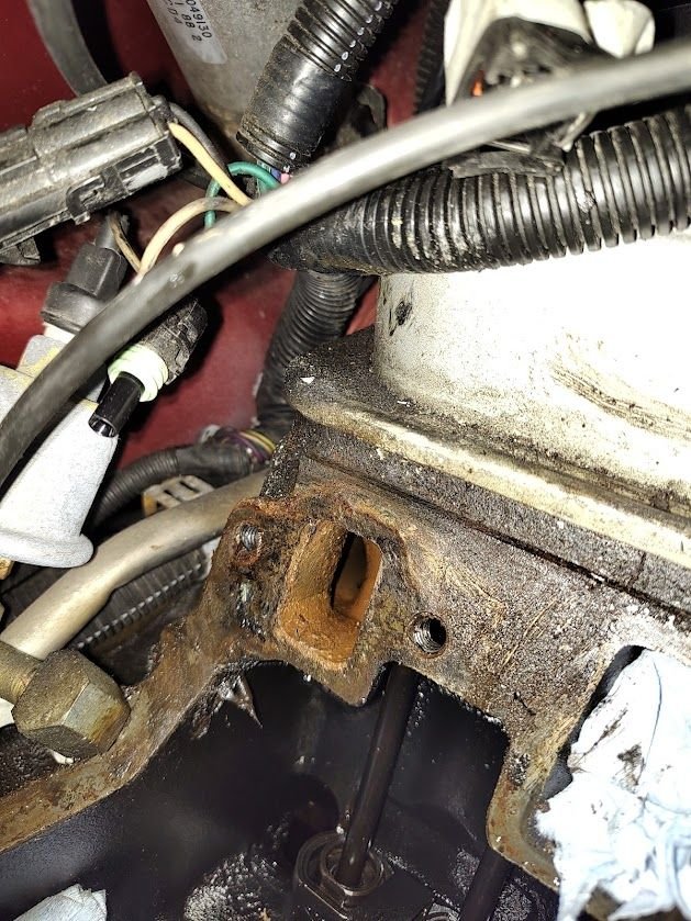

Allright, so we are finally half way there. Just got it all torned apart. Not that bad of a job, just time consuming. Especially since this is my first time.
I wonder if the gaskets have ever been off the car, man were they nasty looking and brittle stuff. It also had the rubber gaskets for the china walls which seem to have been leaking as well.
Anyways, I noticed that the coolant passages were quite brown/rusty looking, especially in the rear. Anything to be concerned about?

The factory didn't use rubber gaskets on the china wall so someone has been in there before.
No, just put it back together.
