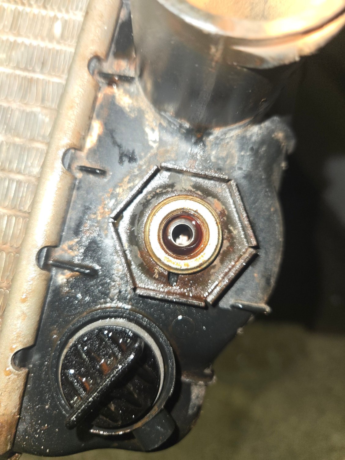

Good afternoon everyone,
I have a stupid question, how do I install the bottom transmission cooling line to my radiator? My radiator went out a week ago so I bought a new Duralast one today. All was well installing it and the top one went on perfectly without an issue. I started the car and immediately the bottom on started gushing out trans fluid, i took it off and installed it as deep as I could and I lined up the fitting, I made sure to line it up and tighten the best I could but again the POS leaked again i took a look at the old radiator and it matches up with the new one. What am I missing??? Also how do I refill the transmission? I checked it afterwards and it was full apparently

Provided the line isn't cross threaded, the flare should seal it. Can you take a picture of the fitting out of the radiator?

I just tried messing with it earlier but I got frustrated so I'll take a picture tomorrow. I did start it by hand and then used a wrench both times. I also noticed the line fitting and line look crooked compared to the top one.

If it's crooked, it's cross threaded. Hopefully you'll be able to thread it straight on the next attempt. Most parts stores will not warranty a radiator with cross threaded cooler lines.

I think it's f'd. This just isn't my year lol How should I try and straighten it out? Or should I just buy another radiator

Yup, that's fornicated.
See if you can remove that aluminum fitting from your old radiator and put it into the new one.

Most of the time, that fitting is the cooler itself. The bigger problem is what the fitting on the line itself looks like now. Again, you may get Lucky by pulling the fitting and trying to very slowly put it in straight. But it's going to take patience and you may end up having to replace the radiator just the same

My game plan is to pull the fitting on the line tonight and seeing what the condition is. If its good, I'll try to slowly screw it on again, hopefully it works, if it doesn't I'll just throw a tantrum and I'll buy a new radiator. If the thread is bad on the line fitting I'll see if I can cut the line, replace the fitting and connect the line using a trans cooling rubber hose and hose clamps. I saw someone do it on youtube but im not sure if its ideal

When you put the line fitting into the rad. fitting if you can't turn the fitting at least 2 turns with your fingers then don't use a wrench. If you cut the line you can use a compression fitting to connect it back together. Found at most hardware stores.

I'm QUITE sure that it is NOT ideal. While that might get the car back on the road, it will leave a permanent legacy of leeeeeeks.
This is a MUCH better solution. https://www.homedepot.com/p/Drill-Am...2-20/305700763 Coupled of course, with a bit more care assembling the line the next time. It might even be possible to remove that fitting from the rad (some you can; some like your particular stock one, you can't) and work on it out in the open.

I wrote an updated last night but it didn't post but thankfully the fitting was cleaned up but not stripped (i double checked and all the threads looked good) so I was able to use it again and it fit into the new radiator I bought yesterday from advanced. Now I'm in a different pickle, when i finished working on it I drove to autozone to pick up some coolant and I figured it wouldn't hurt to ask if they could warranty the stripped radiator. I was completely honest with them on how it happened and they said they could so now I have an extra radiator from autozone...I called advanced to see if I could return it but I doubt they'll take it back since I've already installed it into the car. I haven't started the car to check to see if all is well since I don't want to ruin the return if its possible. I also bought some Dextron 3 to top off the transmission after the half quart got spewed all over the garage floor. Will keep you guys posted and I appreciate the help!

Hard lesson learned. I only made sure it caught the thread the first time and I went a little too crazy with it Thankfully it appears all is well with it. The fitting went on without issues on the new radiator

I'm lucky it didnt strip out, i was going to town with it from frustration on Monday hehe but this time around I made sure it turned a few times before i used the wrench I'll post an update once i get it running. I did notice that the advance auto radiator appears to have the removable fitting but not the duralast one
