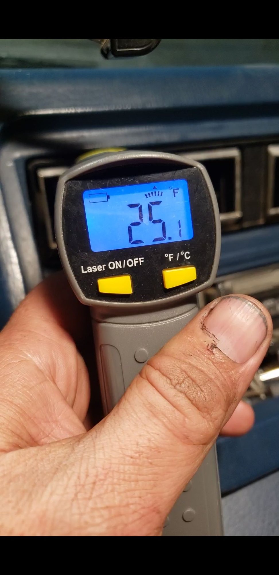

I consider you the ac guru of the forums! I dont recall seeing your thoughts on 152a though. What are your thoughts on the 152a / the air duster stuff vs 134a?
Old Jul 17, 2025 | 04:34 PM
Fast355's Avatar
Joined: Jan 2005
Posts: 10,450
Likes: 508
From: Hurst, Texas
Car: 1983 G20 Chevy
Transmission: 4L60
Re: Who's used Enviro-Safe Arctic Air for R12 systems?
Picture has a hint to my preference for over the past 10 years. Will also add that R152a has signifigantly less head pressure and better cooling. That was in 98F and 65% relative humidity. GM has a chart that shows the high side would be bumping the 420 psi high pressure cutout in those ambient conditions with R134a. I have a massive parallel flow and a lot of airflow but a lot of the reduced pressure is the fact R134a requires a lot more pressure to reach the same condenser temperature. If you ever have anyone touch your vehicle I would go with R134a to prevent someones $$$ recovery machine from getting contaminated during a service procedure that requires an evacuation of the AC system.
This is the chart GM put in the FSM for my 97 Express van. To me it is odd they included the R12 values but it makes for an interesting comparison. The P/T of R152a is closer to R12 than R134a. R152a carries more heat per unit of refrigerant evaporated than either R12 or R134s.
