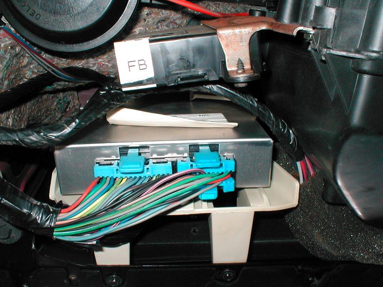

Here is mine. A view from the floor pan.
A question about removal: After I disco the battery and then unplug it, how does it come out from there?

It should just slide out of the plastic holder shown there. There might be little tabs sticking up to retain it in place but a slight push should get it out.

So you are saying that it should slide down and out of the white plastic bracket it sits in?

Looks like it's the Velcro'd mount. try this: push the bottom of the ECM away from the plastic mount, if you hear Velcro letting go and the ECM moves about an inch or so, then pull it straight down and out.
If the ECM doesn't want to move then check the two sides where it contacts the mount. They may be 2 or 4 nuts holding it in place. Loosen those and try the above again.

Peice of cake. It was velcro'd in alright. Slid right out.
