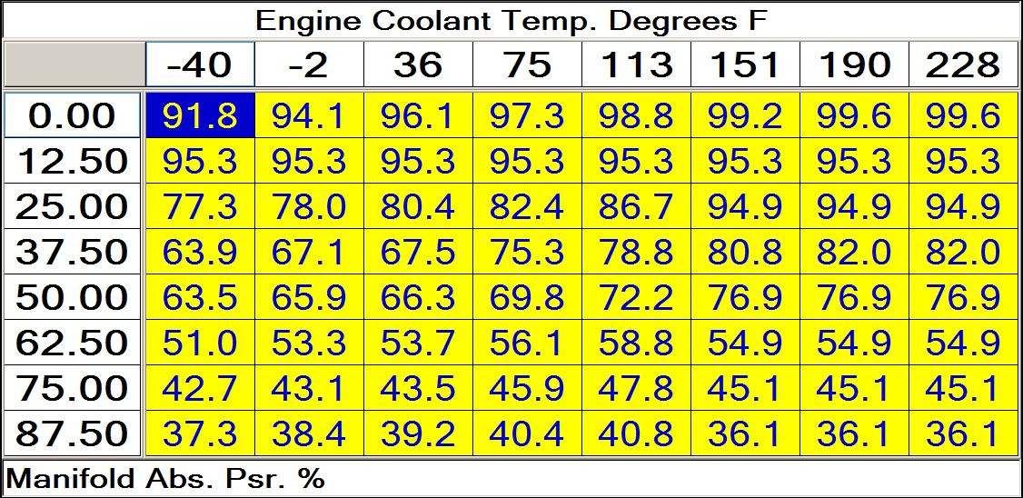

Yes,realistically you could set the top ones all at 100, the next row down at 99, next row at 98, etc. and it'll have virtually no impact on fueling at that point. Again, I strongly disagree with this point, but yes, you can do it. No, TPS rate of change is NOT as effective as Tau fueling. Tau fueling is all about the liquid fuel clinging to the intake wall (yes, there is always some) and that when there is an instant need, it can pull from this "extra" fuel and put it in the cylinders. You can never accurately get 100% of the needed fuel in the cyl for each individual filing event. So this fuel comes in handy for tip-in and other immediate-draw events. So, what you are setting is basically at idle there is X amount of fuel on the intake. When you tip in, then there is X-Y amount on the intake, and when you let off the throttle, there is some Z amount that builds up (if all is perfect) to our previous X level; i.e. Z+Y=X. Make sense?
Now on the other point, what I'm referring to is changing your default MAP range; i.e. instead of having 16 equally spaced steps, I change mine so that I have less spacing where I don't need it; i.e. 0-20 is only 1 point, and more at key areas for better resolution; i.e. 20-30 has 4 points, 80-105 has 5 points, then a smattering in between those for transition. You can then scale the manifold pressure as needed and desired for your motor. Does that make sense?

Ya, I really don't fully understand the Tau table, because it's kinda like black magic. I can tell you the #'s that mine has in it.
