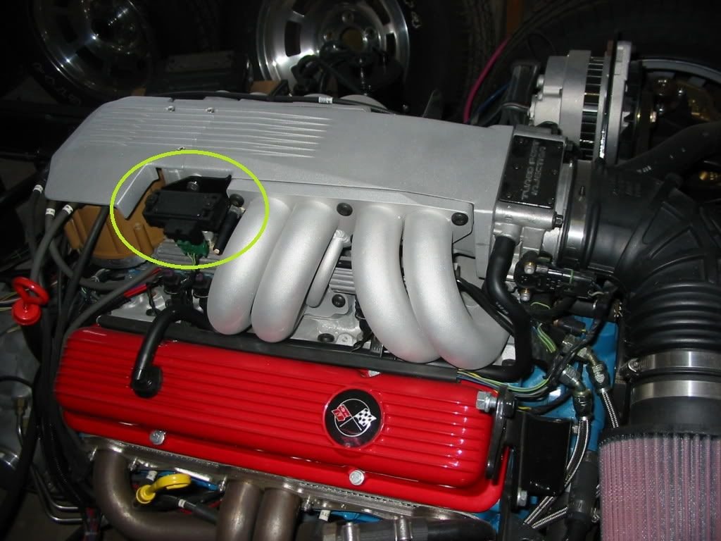

If you mean the air temp sensor, then yes. That guy looks kinda like a temp sensor that is on the rear underside of the plenum.

That's the MAP sensor being depicted in the photo. It measures pressure not temperature. The MAT sensor is on the under side of the plenum. It's a brass body with a NPT threaded end that screws into the bottom of the plenum.

That's what I was thinking my Chilton's said it was on the opposite side of the mapin one of the bolts holding the tubes to the plenum I seen the sensor underneath that I figured that's what it was but wasn't sure Thanks

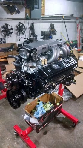

Nice engine greenyone

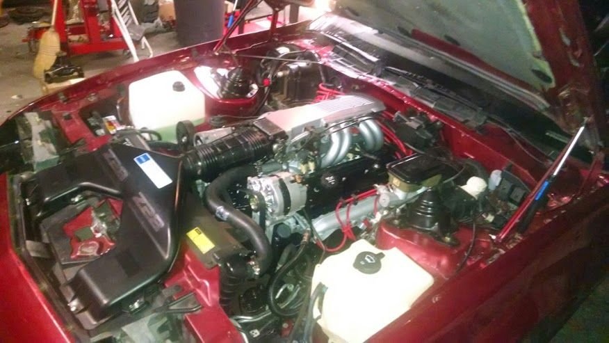

HA! That's a google search photo. Mine is new and clean, but doesn't have the Captain America paint job.
