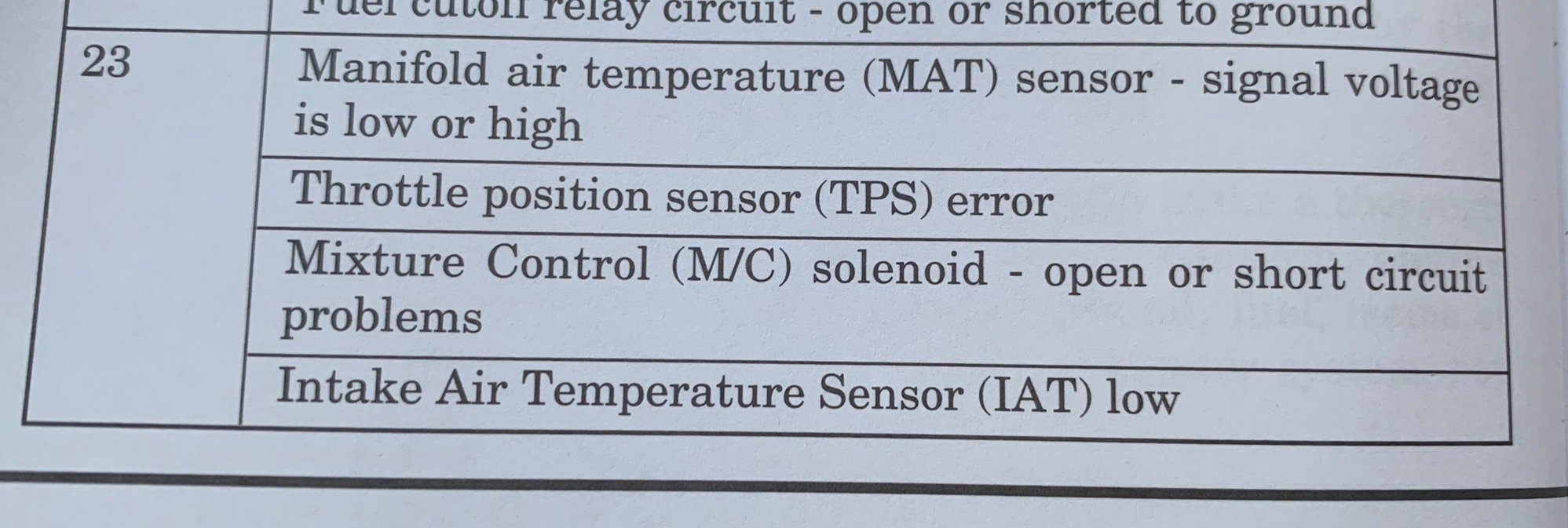

First off, the car is a 92 305 TBI and I have a GM code reader and its owner’s manual that says what each code means. Starting yesterday my engine light came on, so I stuck the code reader in and it flashes a total of 7 times but stuttered on the 5th flash and stayed on while in “run.” No repeating codes at all. Without the code reader it flashes 7 times like I understand is normal but stays on while the engine is running like there is a code. Yesterday morning had this same glitchy code, but leaving work yesterday did not have any code. I plugged the reader in and only got code 12 like it should and it flashed 7 times while running and stayed off. This morning had this glitchy code again. The engine has been running flawlessly with and without the glitchy code.
This exact same thing happened a couple months ago where the engine light would come on mostly while cold and went off while warm at highway speeds until my distributor rotor finally went out, but it also gave me what looked like codes 52 or 53. 52 being either an ECM problem or system voltage too high, and 53 being system voltage to ECM too high, alternator voltage not normal or VATS fault. I doubt those codes are relevant but I thought I’d mention it. I replaced the distributor rotor and the cap and all engine codes disappeared and it no longer flashed 7 times while starting the car. The only code it had while off was 12, which is normal. But now that problem has come back and the car runs better than it ever has.
The owner’s manual for the code reader doesn’t mention anything like this, and I haven’t seen any other posts about this. Any blatantly obvious ideas that I’m missing?

Hopefully final update. I still think the issue is electrical at this point, and haven’t done anything yet. The car has been functioning fine, and I arrived at a restaurant early to meet my roommate and idled for a little bit, and the engine code turned off. I shut the car off immediately and tested the code and got the diagnostic code and code 23. Finally! According to my code reader book, it could be a few different issues, but at least I know where to start now.
I had been suspecting the TPS to be going out, and it looks like I might be right. I’m still going to look into the electrical issue at some point. Thanks anyone who might have seen this.
