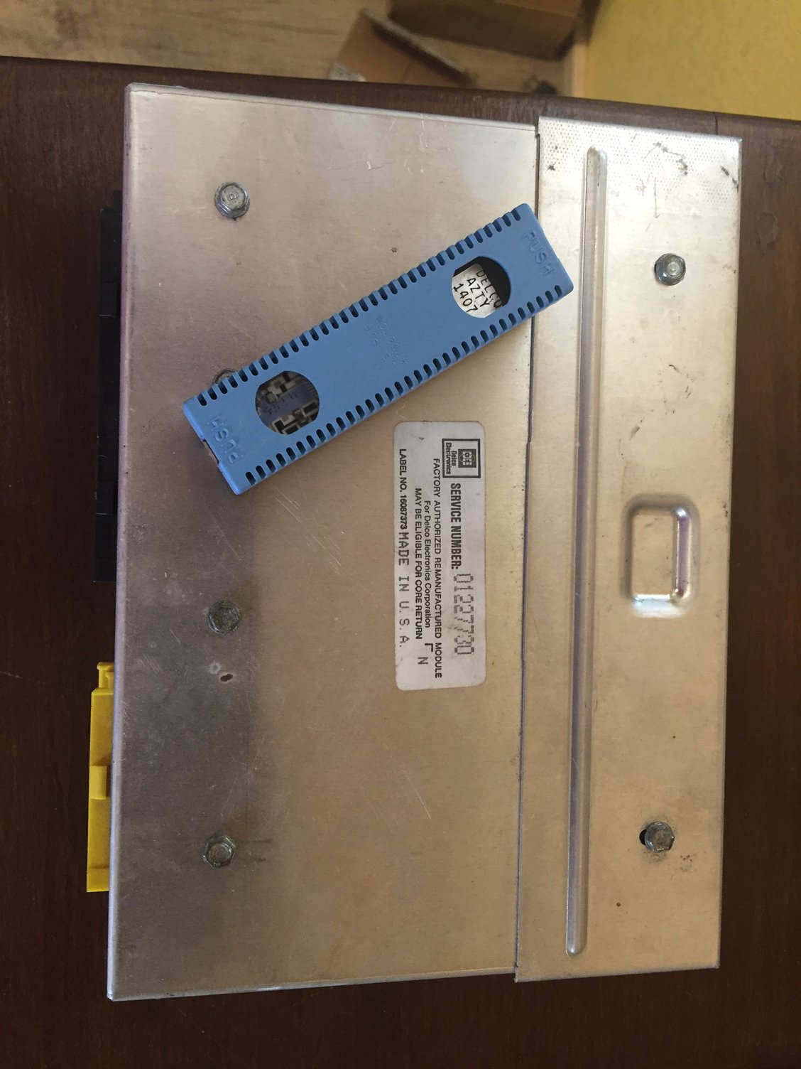

Re: Code 51 firebird 1992 3.1 L v6
Yes disconnect the battery. Pull the Accel cover off the computer. Rock back the white and blue levers and pop out the blue memcal chip.
then reinsert the memcal and connect the battery.

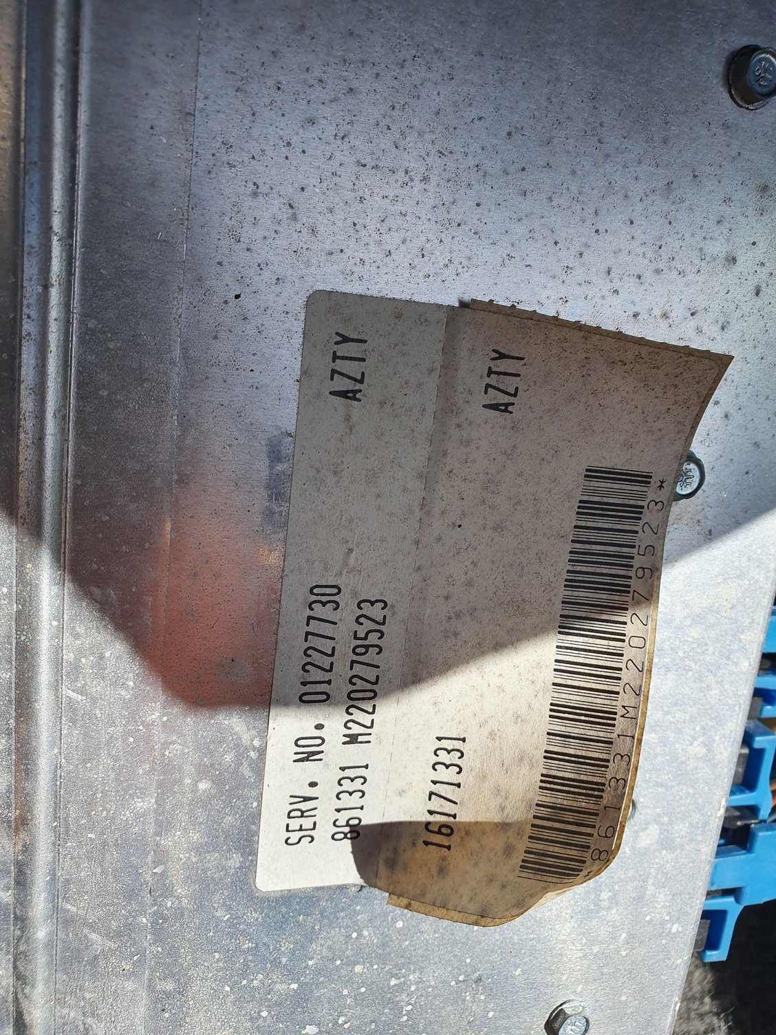

1227730 is the ecm service part number. Azty is the memcal numbers for 3.1l Automatic
This is what I have , no rush on a decision.
