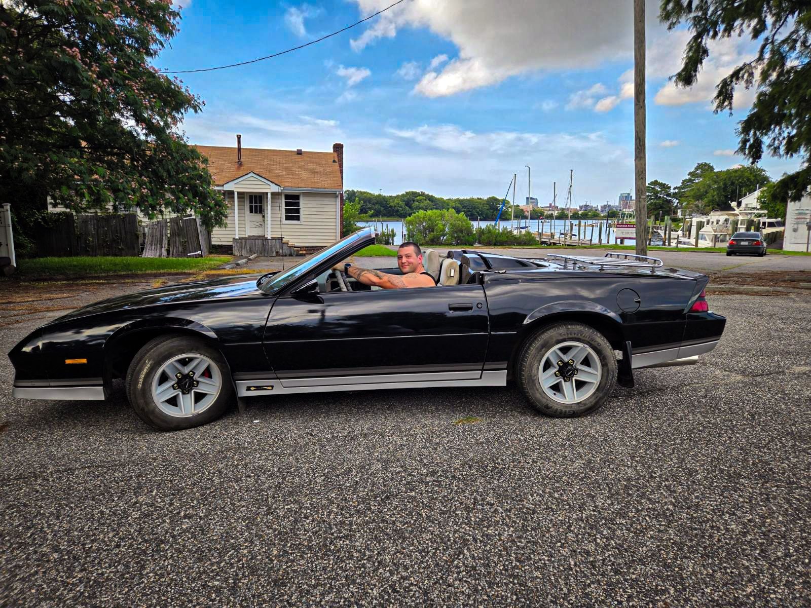

sounds like a plan. Some reason earlier today, i got the injector firing for a solid half hour probably. Got to take her on the road for the first time in 20+ years. Got the wife in her and took a small trip down the street and around the block. Discovered some other minor things but the injectors both fired the whole time. No telling how tomorrow will go with them lol Got to put her back on jackstands and dig into some suspension issues so whenever that comes around ill do exactly as you suggested.
thank you so much for digging through for another possible ecm. Ill gladly buy that off your hands. It's awesome to talk to someone with cfi knowledge.

Could also look over the plugs that plug on top of the injectors if you have not already.Very cool car BTW .
