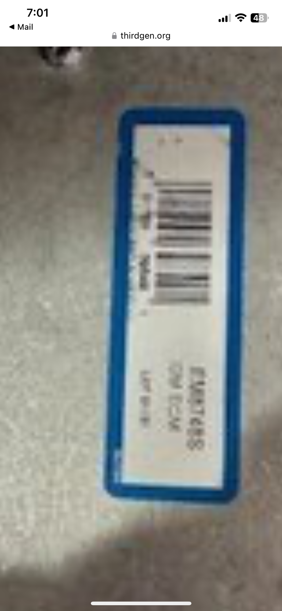

[img alt="Ok guys, my son bought a 1990 Camaro RS and we got it last week. It has the 5.0 and an automatic. We have slowly started working on it and it was idling high, running rich and not running well. After some research I have come to the conclusion that this is my problem. Can anyone tell me if this is the right ECU and what CALPAC and PROM. I need? That is if those are even the right terms? TIA
"]https://cimg5.ibsrv.net/gimg/www.thirdgen.org-vbulletin/2000x1504/img_2144_08c787a232ec06c5a45615fc243e9077e6ea8d0b.jpeg[/img]
Ok guys, my son bought a 1990 Camaro RS and we got it last week. It has the 5.0 and an automatic. We have slowly started working on it and it was idling high, running rich and not running well. After some research I have come to the conclusion that this is my problem. Can anyone tell me if this is the right ECU and what CALPAC and PROM. I need? That is if those are even the right terms? TIA First post so please forgive any errors.

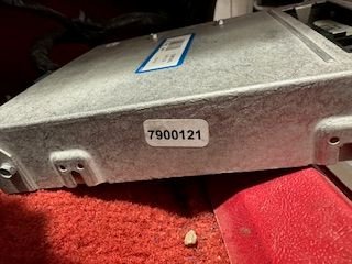

Can you post a picture of the ecm and silver sticker on the prom. It would have a 1228746 ecm. Any stored codes or vacuum leaks found ?

There will be a service number sticker on the ecm. It looks like a 1228746 with no prom installed. Your running in lhm

Hope these come through and help.

It’s a cardone refurbished ecm, I can’t make out the numbers 778746 ?

Sorry. It didn’t transfer well. EM8746S

The missing prom the ecm wouldn’t recognize a missing hz signal from the passkey if not working properly. Might try the linked prom or can message me I can do a vats delete chip.
pretty sure that’s a cardone number for the ecm for your application
Are there supposed to be chips in both spots?
the 1228746 has the calpak soldered in .It was v8 use only .unlike the 1227747 truck ecm. It just needs a prom.
