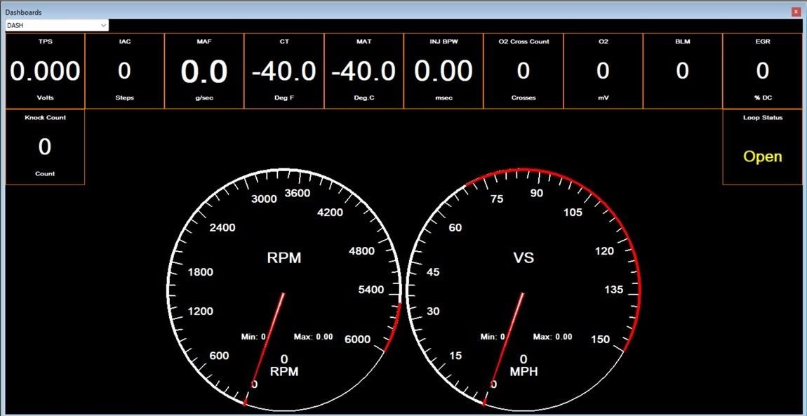

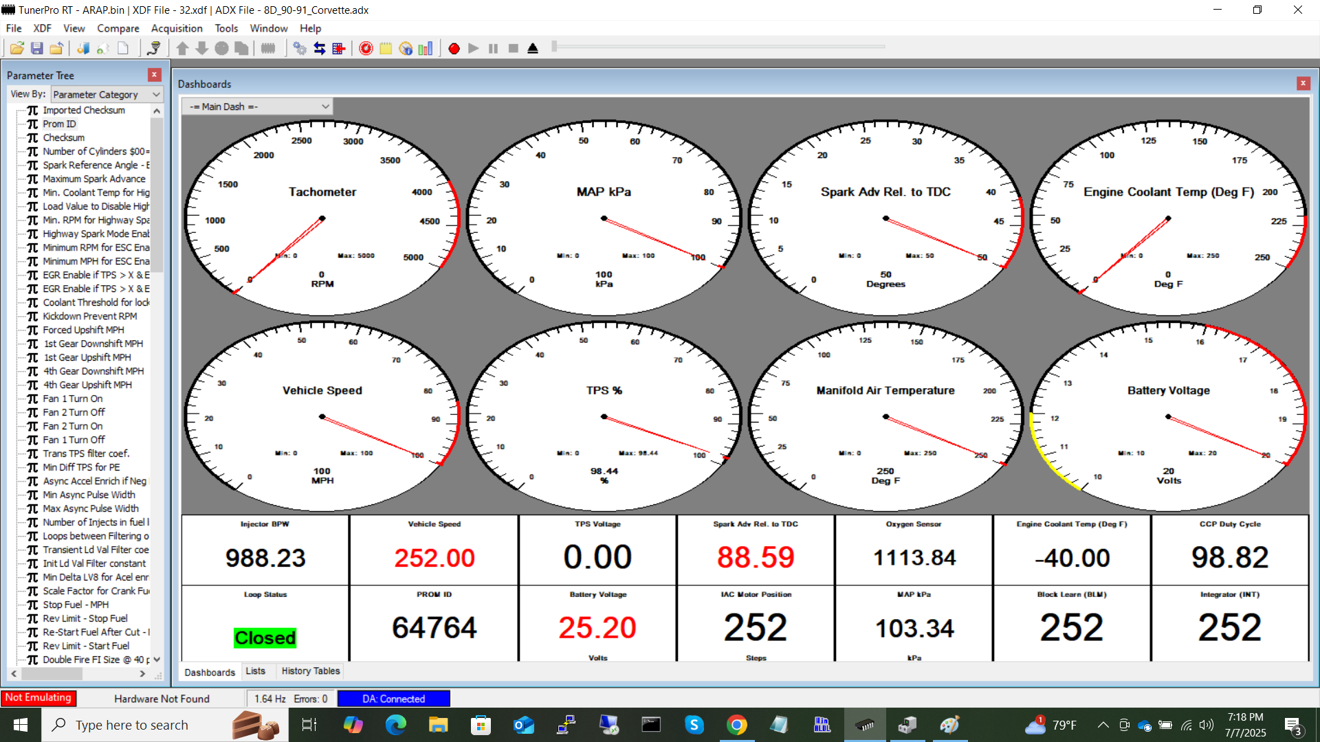

Old Jul 7, 2025 | 06:19 PM
salaberrios's Avatar
Joined: May 2024
Posts: 29
From: Pickerington, Ohio
Car: Suburban, Mustang, Camaro
Re: TunerPro RT and ADX file question
check out these screen captures. note the file names up top and connection status
the data is not accurate. but it connects. Anny help to getthis right is appreciated.
Attached Thumbnails TunerPro RT and ADX file question-dash-no-connect.png   TunerPro RT and ADX file question-dash-connect-using-crvette
Old Jul 7, 2025 | 06:27 PM
Tuned Performance's Avatar
Community Influencer
iTrader: (95)
Posts: 16,901
Likes: 1,014
From: Mile High Country !!!
Car: 1967 Camaro, 91 z28
Engine: Lb9
Transmission: M20
so yeah it’s like using a road map for one state while in another.
