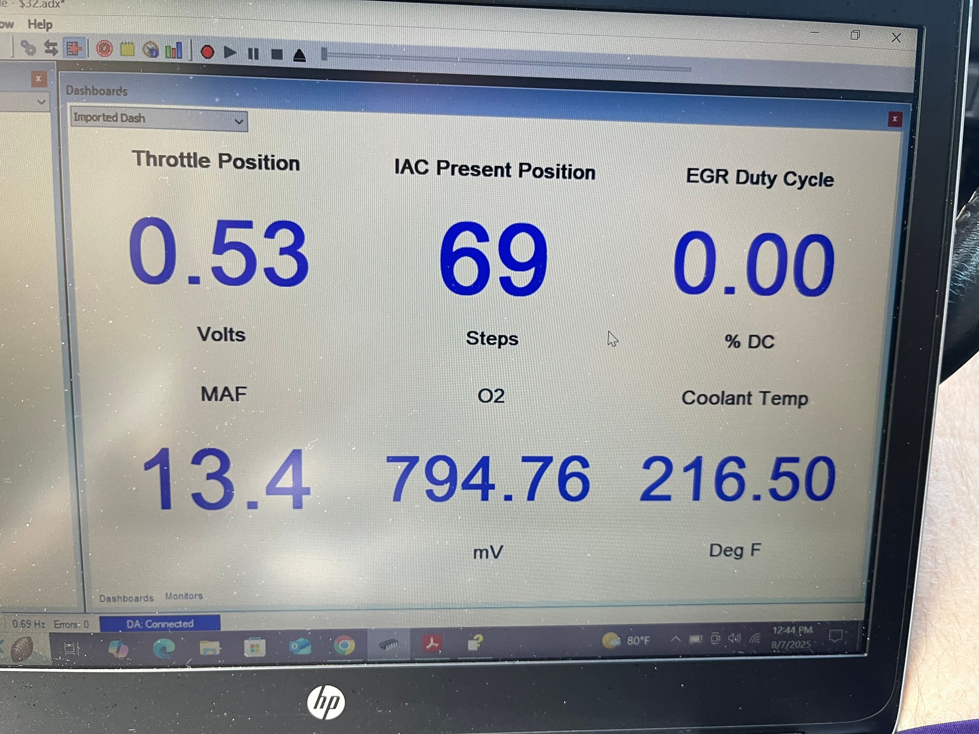

I was able to configure some of the information, still learning. Nothing has stood out to me yet as a red flag. Any input on what’s a normal range for the O2 it was all over the spectrum and I just replaced that based off of pulling codes with a paper clip prior to the cable.

Iac steps seem high so does maf reading.

Car is stock other than an old stage one Jet chip as far as I can tell. I also replaced the MAF sensor as it was throwing 33/34 codes when I first got the car to run. spark plugs were black like a rich condition. Thoughts on what path to head down? you mentioned hi counts on the IAC and the MAF, what in you opinion could cause that? When connected to the car with TunerPro it did seem to pickup idle and I was driving a bit with the cable connected. I will scan the forums and see what I can learn rather than keep bothering you for info. Thanks for the help thus far though!

Assuming this picture was idle maf gps should be closer to 6. With minimum idle speed set iac steps warm engine will be closer to 20-25 steps . Might have to open throttle blades then readjust tps. Can use tp to see data and adjust or set minimum idle speed with iac command in and unplugged. Not sure on the maf reading any rip in the bellows ?

I believe I grabbed this while I was out driving and came to a stop and it was at idle and snapped a pic. I will have to double check the bellows but believe that there are no rips or holes. I know that the report back is slow when it comes to data. I noticed when I went to test the tps it took a few seconds for it to register on the laptop. I will have to do some investigating and maybe regrab some data and repost later today.
