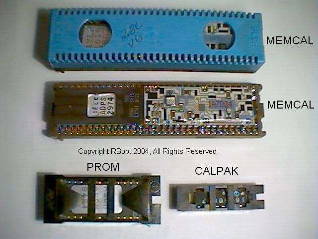

Not Sure But You might also need the calPak. At the botton of this picture Link Provided By Rbob are what the prom and Calpak look like for a 870' or similar ECM
If ya need the calpak the Ac Delco # 16042430 for $18.57
