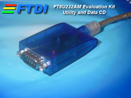

Is the moates USB to ALDL cable the only one out there so far? I havent seen another. I understand that it may solve alot of problems but its $80.
This USB to serial convertor contains the FTDI chipset, which can support the 8192 baud rate. It works, I use it myself. (you still need to make yourself an serial-to-aldl convertor though)

Anyone looking for a Serial to USB cable FTDI makes one thats USB 2 capable for $35. Its distributed by http://www.saelig.com.
Attached Thumbnails Was using Tunerpro 4.0, tried to upgrade now its not working-us232a.gif
