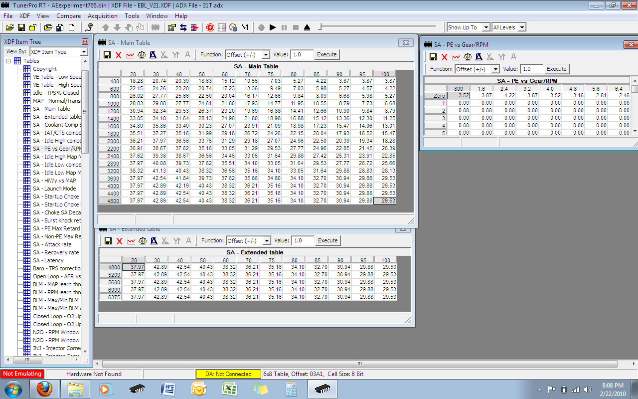

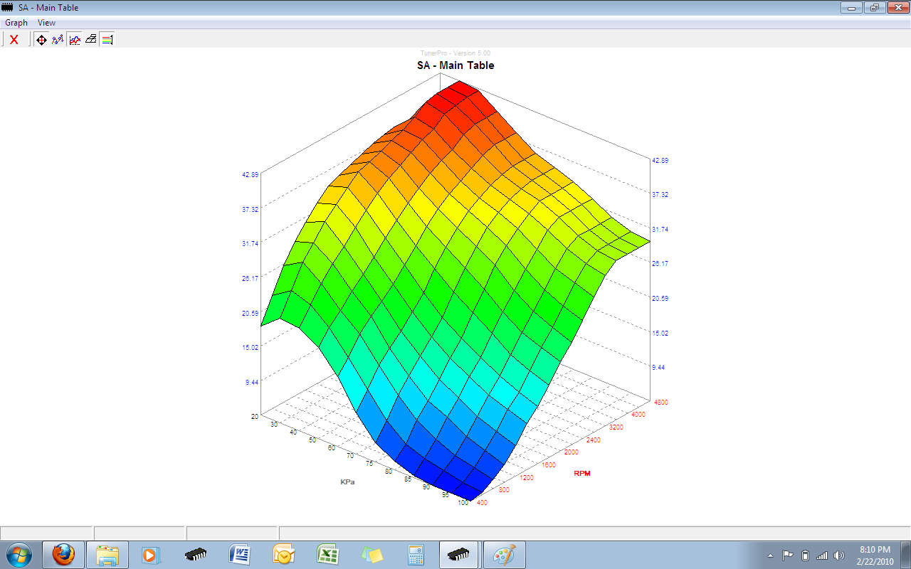

Old Feb 22, 2010 | 07:16 PM
liquidh8's Avatar
Joined: Aug 2004
Posts: 682
From: Shippensburg, PA
Car: 1981 Buick Century Wagon
Engine: 87 GN engine
Transmission: 2004R
Re: Bin selection
These are what i think I am still using. I would actually have to hook the laptop up to the car to see my current bin number. But these should be close to what I am using. I have the n2o table pulling spark out for the spray, and I was 89 octane gas. So with 91/93 my lower MAP vs RPM spark numbers would be a bit higher.
Just give it what it likes, as told by a wise man to me a long time ago. I was so worried about running over 32d total at WOT, but this engine wanted more. Even though they say the vortecs don't like all that much timing. I had some track time too when I just played with the WOT spark, the lower part was me getting rid of surge and getting the pull while the engine was lugging in overdrive with the converter locked.
Give this a try if you'd like, but as with any bins, use at your own risk!
Attached Thumbnails Bin selection-vortec-spark-table-wagon   Bin selection-vortec-spark-table-graph

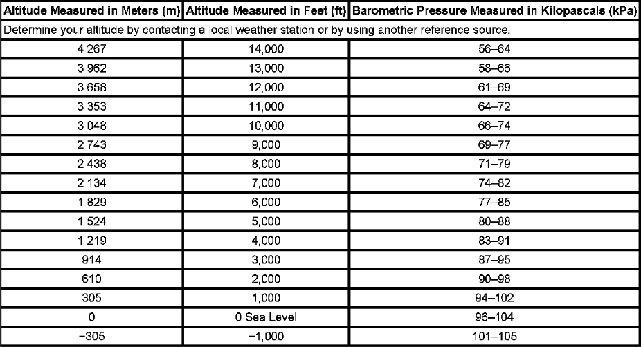

Originally Posted by exopar
Very nice and helpful.
Will give a try with this tables and see what comes out.
Also have noticed this engine not to reach 100 KPA`s
It moves between 30 and 70`s high all the time.
We are tunning very high over sea level (2250mts) but I still think It should be reaching at leats 85 - 90 right?
All 8 cilinderas have 120 steady psi compresion and seems by the way it idles no leack in the system. Runs very rich when cold startup and still can not get rid of this problem.
May this kpa`s been affecting my overall power? I really do not know how to cure it.
2250 meters? according to this chart, that seems right.
