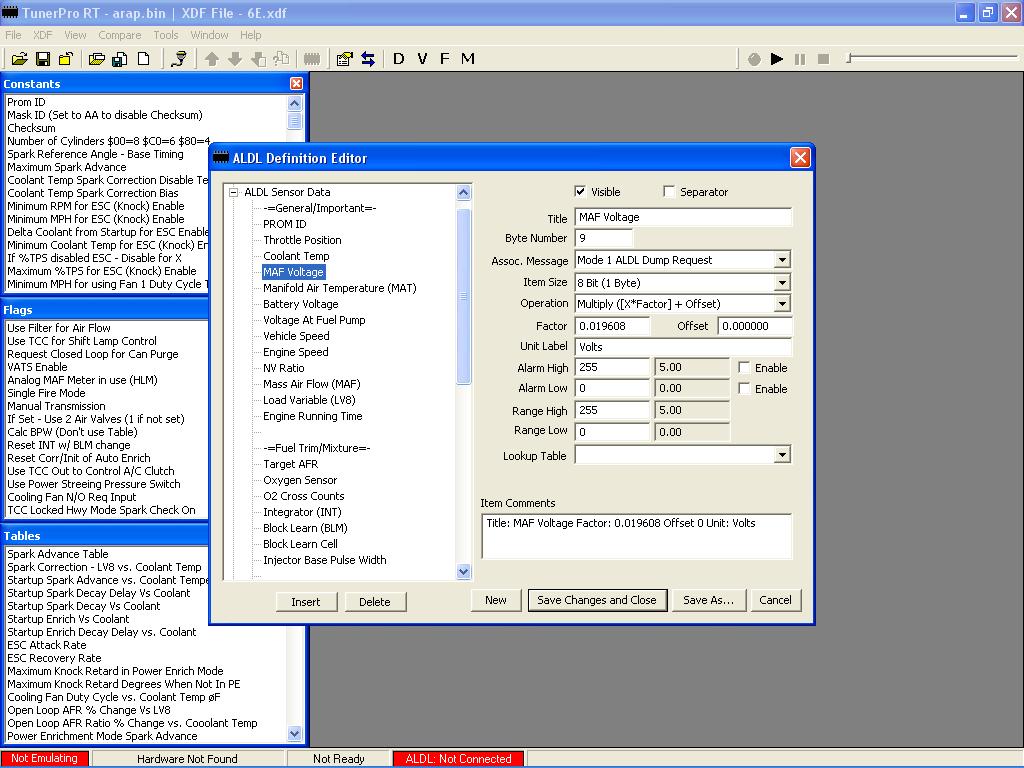

1. Acquisition->Edit Definition
2. Expand "values" and choose an entry to replace. (I used "Startup Coolant Temp", since I don't really need that in the datastream)
3. Change the Title to "MAF Voltage"
4. Change the Unit Display to "Volts"
5. Change the range low and range high to 0 and 5.
6. Click on the "Conversion" tab at the bottom, and then click the "Set" button.
7. Enter X*.019608 and click "OK"
8. Click "Save"
9. Check and see if it works!

Thanks, that seems to work. I also added no offset to the equation, is that right?

Ok, We're we're changing two different files here. The first step, when you went into the hex editor and changed 60 to F3, is a change to the .bin file that you burn to your chip and put in your car.
This points the ECM to a different value to send through the ALDL, instead of sending the Startup Coolant Temp value, its now sending the MAF Voltage value.
The second part is editing the .adx file (.ads in TP4?) This is where you edit the title and the units you see in your datalog, and also where you put in the conversion factor, since the actual value the ECM is sending doesn't make any sense to anything but a computer.

Re: Help adding MAF voltage to the datastream?
Originally Posted by caboboy
Thanks!
I need to get to get awaay from this for a while..................all I'm getting now is a mismatched ADS & XDF file.
I like to save my changes as a new bin ie; 'Save AS' to make sure it works, if not, you have the previous bin to go back to.
Try it again in the morning with a fresh mind.
Old Jul 19, 2011 | 08:52 PM
caboboy's Avatar
Joined: Mar 2004
Posts: 79
From: SF Bay Area, California
Car: '87 Corvette Convertible
Engine: 421 CID, Superram, LPE219, AFR 195s
Transmission: Built A4
Axle/Gears: D44 w/ 3.07s
OK, I got it thanks to all the help from you guys!
Now...........I gotta figure out what I'm gonna do with the new info. At first glance it doesn't look like there will be much advantage. Maybe it can somehow give me more resolution to the data points........?
Thanks to everybody!
