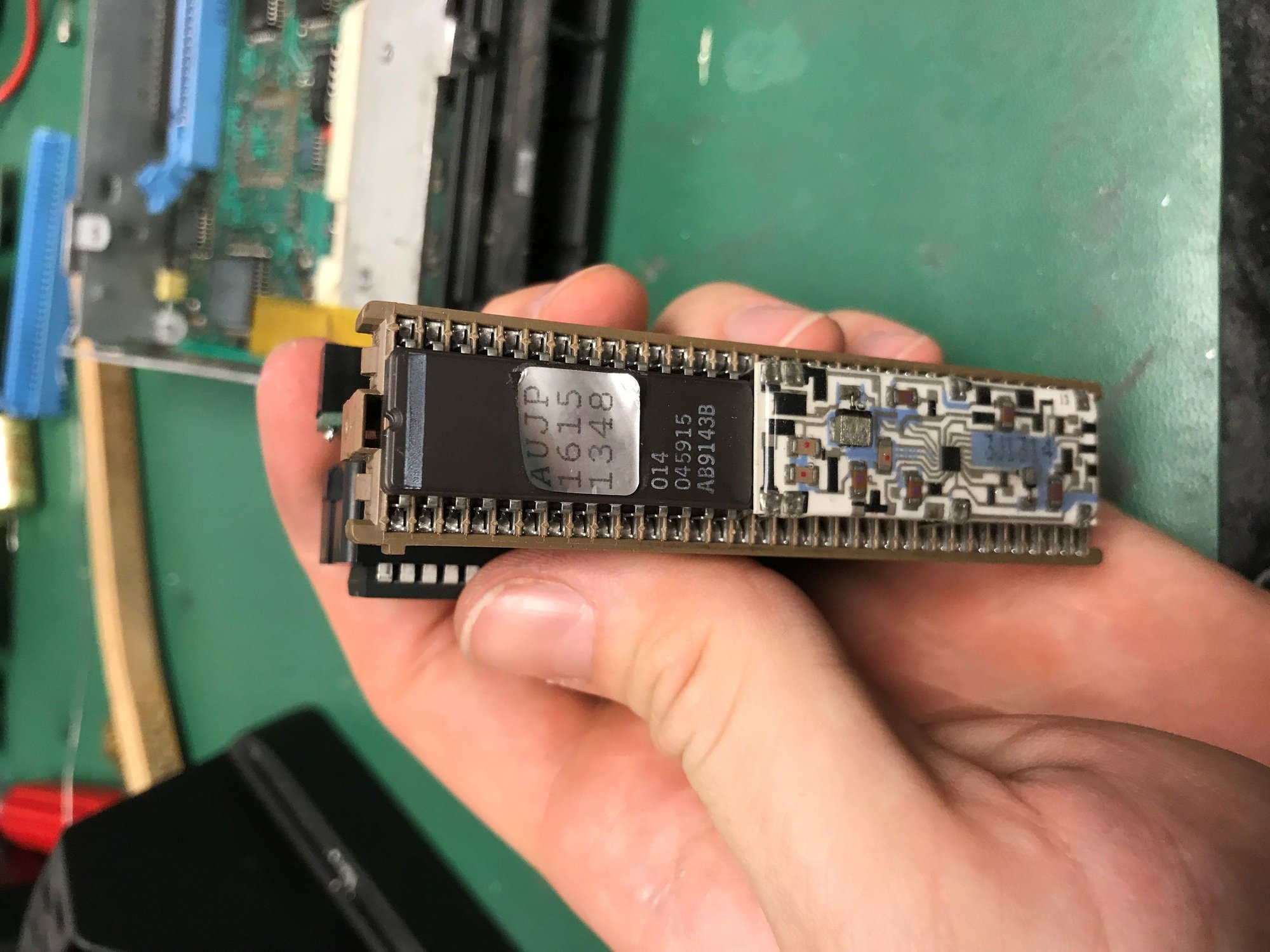

The AUJP(?) MEMCAL isn't plugged into the header correctly. Code 41 is a cylinder select error. Which the ECM firmware reads the cylinder count setup from the ECM hardware and it doesn't match the PROM calibration cylinder count.
As for the AUJP MEMCAL, are you sure it is a real AUJP MEMCAL?

As for being a real aujp. The knock board has letters and numbers on it. A real aujp has the second digit is a R .
RBob.
I'll verify for sure the next time I have it in my hand. I purchased from a recommended TGO member at a pretty steep price so I hope it is a true AUJP. But I have decent faith in it being good since the car runs much better and throws no codes with just the AUJP memcal connected sans the adapter and chip.

Here are the markings on my AUJP chip that I bought from GM a while ago. You can compare against the one you have.
Attached Thumbnails TBI -> MAF -> SD -- Doesn't like any tuning, send help!-20180504_102526-1-.jpg   TBI -> MAF -> SD -- Doesn't like any tuning, send help!-20180504_102520-1-.jpg   TBI -> MAF -> SD -- Doesn't like any tuning, send help!-20180504_102500-1-.jpg
the number on the resistor pack is different on mine but they seem identical otherwise. I triple checked that I was installing everything correctly and no change. I didn’t get around to verifying the harness yet, but I still don’t see where that could be the problem if the stock memcal works fine.

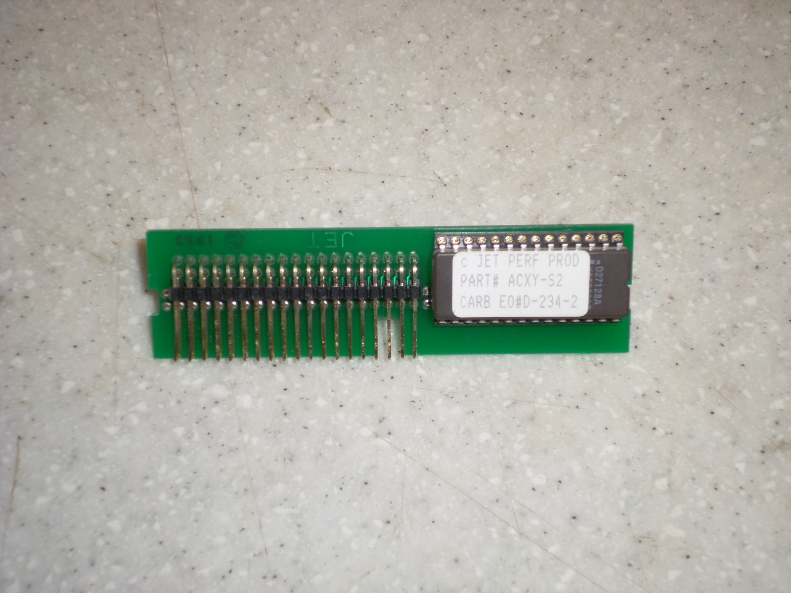

Here’s one for cheaper
https://m.ebay.com/itm/Hypertech-152...ty!97007!US!-1
This comports with the photo that I posted of my AUJP. You had said earlier that your resistor pack has different markings. Are you absolutely positive you have a real AUJP?

I'm with RBob... there's something going on with the connection between the adapter, chip, memcal, ECM, etc...
Just a couple of other thoughts after reading back through this thread...
TunedPerformance said earlier...
Also, I think you should backprobe the ECM harness with a multi-meter to ensure the re-pin from MAF was done correctly.
http://chevythunder.com/fuel%20injec...20(ecm#1227730)
There's something (or some combination of somethings) that's resulting in a very unlikely scenario.
I missed TunedPerformance's remark on this somehow... Now I am wondering what the **** I have here and who's gonna get a talking to if its not an AUJP... Can anyone identify for real from the photo below? I took it for granted it was correct because I didn't really have any way of proving it wasn't...
Not the clearest photo but it looks like the second letter there is a 'J'. This is a previous photo I took but I can check closer later..

does the "1R" have something to do with the being a 350?
I was scanning through Ebay and although I didn't see any AUJP's, all the 90-91 Corvette chips have "1R" on the resistor packs. But the non-350 Camaro chips had something else...

I’m currently out of town but I have a few aujp.
They all have a r as a second digit. I think the rest is the production date.
Example 1 as in 91 then the day of the year.
Looks like you need to install a cylinder select jumper.
https://www.thirdgen.org/forums/diy-...d-density.html
The netress and I believe it’s called I/o buffer chips are marked
16072665 & 16133420
http://www.gearhead-efi.com/Fuel-Inj...uot-on-727-730
