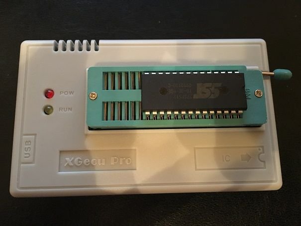

I am new to programming here, great site and people here for help with tuning! I have the Amazon burner which came in as XGecu Pro instead of Mini Pro I see around here that others have. I found the Xgpro software and drivers and all appears to work and is a very similar GUI to Mini Pro, the drivers do not work with the Mini Pro software, maybe a conflict as I already had this Xgpro software/drivers. Everything appears to work but the chip will not run the engine for more than a couple seconds. This is a SD TPI with 7730 ECM with a mild 350 in a Fiero. I have the GP1 package and HDR1 from Moates, I can read the original chip with this hardware/software and open and view all data in Tunerpro. I tried burning the stock tune and it runs the car the same I can pull the chip off the ZIF and it does the same so something is not happening.
I read about offsets and the bin files are 32K in size so I set it up as buffer address range 000000 and end 007FFF in the address range of Xgpro software per Moates offset info. Then I setup at to program start of 08000 and 00FFFF but this still did not take. For now I am just trying to get the original tune to work on a SST27SF512 PROM via the ZIF setup then I can play from there. So I decided to read this burn I did of the original tune and the first thing I looked at in Tunerpro was injector flow rate and this was at 0.16 #/Hr, I then went to the compare option in TP and the original tune shows 20.99 #/Hr, next thing I looked at was VATS and it is enabled or selected in the burned bin vs the original so I started looking at everything and it is all different.

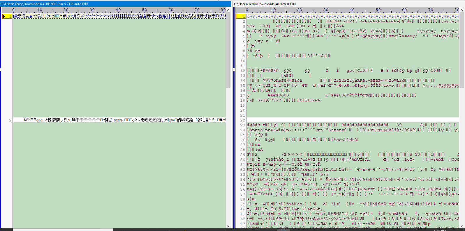

Might try first comparing the bins outside TPro in a binary compare program to see if there is truly an offset issue, or just have garbled data. The attached (AptDiff) gives a good view. While there will be differences seen in the calibration (0x0000 - 0x9807), should be NO differences in the code from 0x3000 onward. Compare and that may reveal the issue.

Thanks 84Elky these are definitely different I am seeing all 00 in offset hex in original tune and all FF in copied to SST chip version.

I am using the XGecu Pro branded version for hardware/software:
This is the original tune chip I read there is a yellow round sticker that has HTM on it over the "window".
Maybe I will just return it and go with Moates Burn2, at this point $30 more would have been worth my time I just thought this could do more if ever needed.

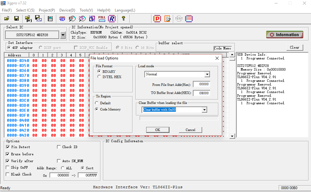

I got it! I was doing it wrong with the buffer address. I found this post https://www.thirdgen.org/forums/diy-...sd-doesnt.html and followed your instructions here:
From File Start Address 00000
To Buffer Start Address 08000
Clear Buffer with 0x00
I was not choosing this clear buffer correctly.Then program 84Elky sent me states it is a match.

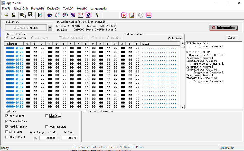

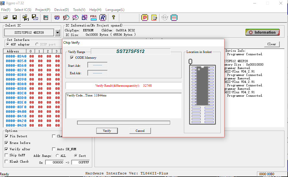

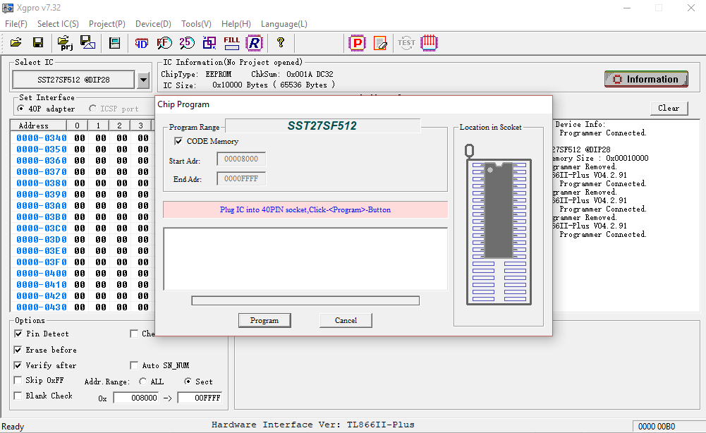

I downloaded a fresh AUJP bin and all looks good in TunerPro. I programmed it, read it then compare in TunerPro and I am back to square one. I think I did not read the last one and this is why it matched. I am back to my 0.16#.Hr injector flow rate. How I am reading this I open bin then select File Load Options like below:
Below is the loaded bin:
Then I select Program and Start address and end address a below:
Then after a chip verify I get this:
Then I read chip save file then compare and get this:
Anything I am doing wrong you can see?

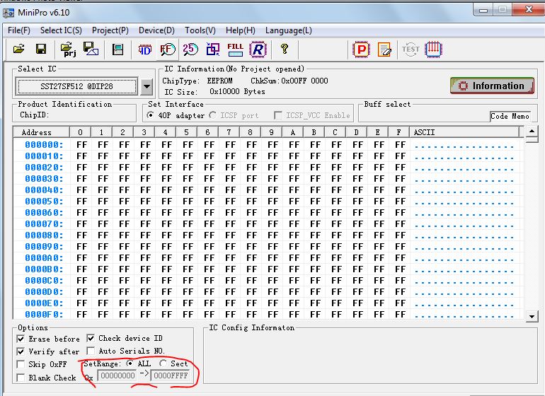

The only difference I can see is I have my Set Range set to "All".
Just to rule out some other issue beside the programmer, send me your bin. ultm8z@yahoo.com. I'll open it and see if I get the same results.
Attached Thumbnails Programmed bin does not match bin used-minipro-set-range.jpg
