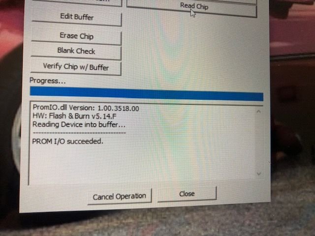

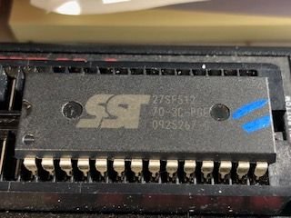

As far as your $6e chip you can’t read, have you tried reading as a 27c128 ?
It could be another chip moates burn 2 is not capable of reading. I had this occur awhile back and had to use my pocket programmer to do a read.
Your pic is to small to read

Burn2 Moates reads eprom ok but not able to find file/bin in directories. Is there a trick to finding this read?
This is chip that somehow got the right info. Just needs midrange and wot adjusted. Tried to find file and read in Tunerpro. I originally burned this but didn't write it down. lol

thanks, Orr89 has made an impact on this tune also. Started tonight and IDLE .....ed Great tonight. Thanks for file tagging help... it Worked.
