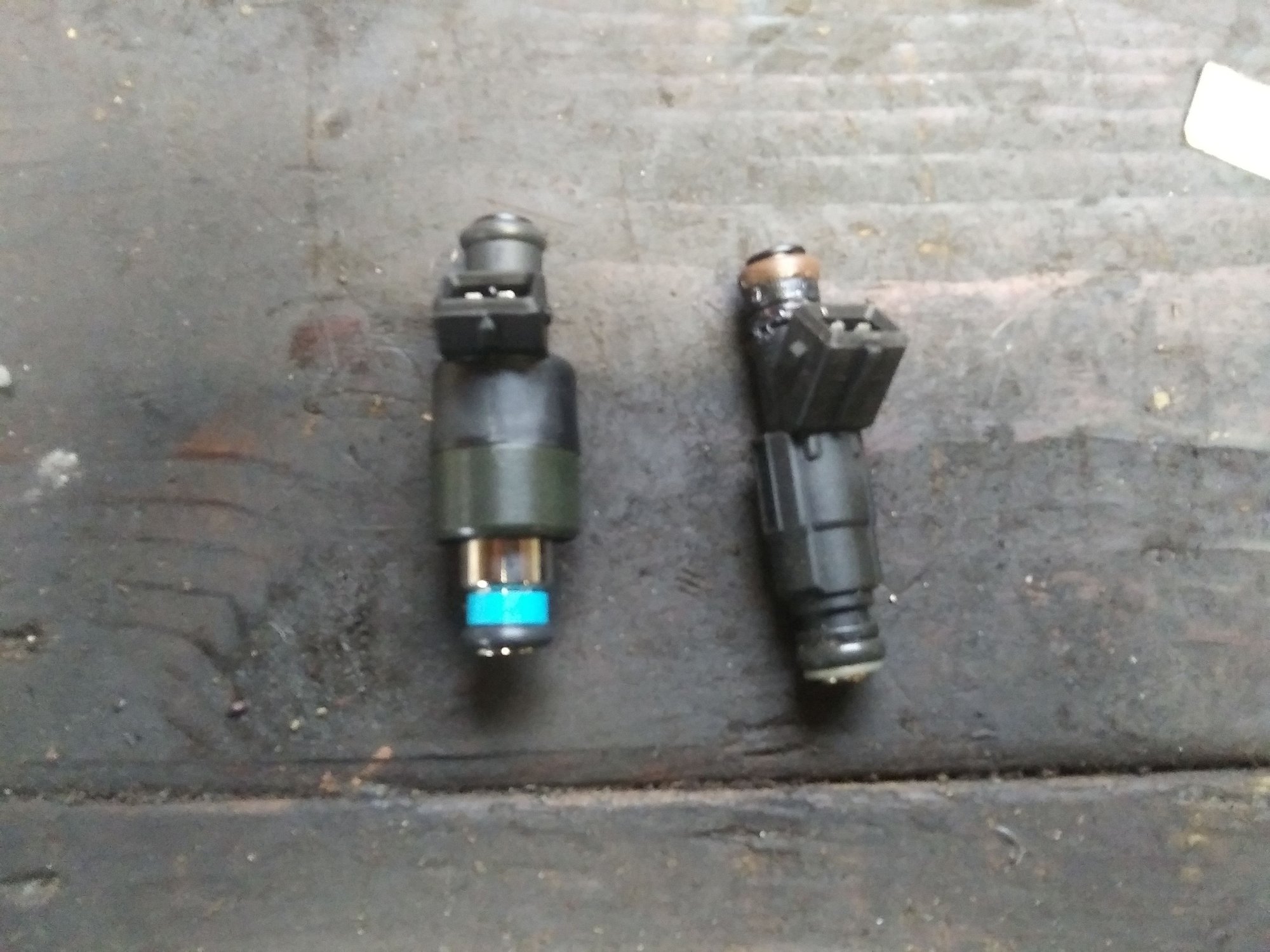

Can you post a picture of the injectors they sent you as well as the ones you bought from ebay?

the one on the left is an ultra power MFI101 from rock auto the on the right is from ebay.

I went back and checked emails and the ebay seller was ultimate components.
