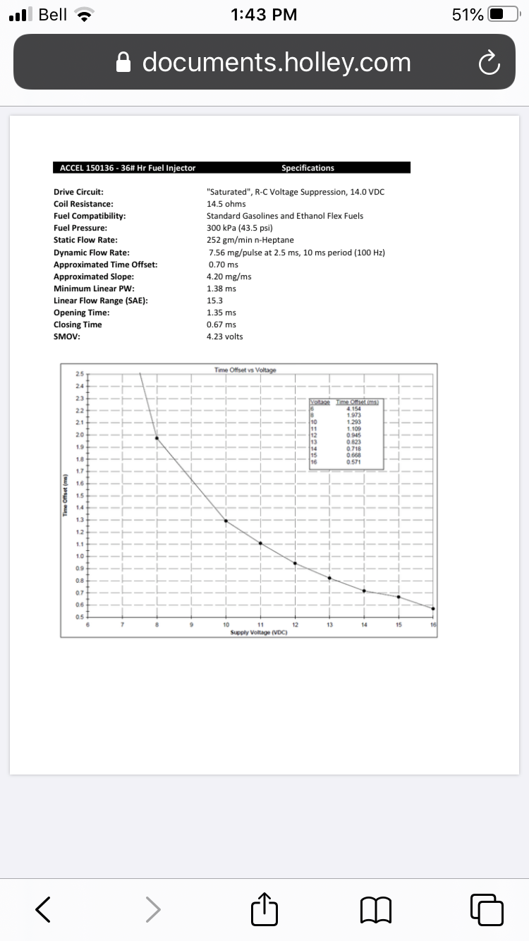

i manage to borrow a set of accel 01D114B 40lb injectors from a friend
it should be enough for my 383 600hp engine
racetronix sells them as well but they say 37lb
i did a bit of research and they actually are 37lb
this is the following specs are in pic
my question is i know what to input in the offset correction table
but what about small pw correction and single fire mode pw?

It's the voltage vs time offset table in the graph. Not sure what the ELB table looks like, but often times with $8D in the 7730, the tested voltages on the injector datasheet don't line up with the voltages in the table within the calibration, so you have to linearly interpolate to get the voltage. Let's say the they tested at 13V and 14V, and your EBL table entry only has 13.3V. You have to linearly interpolate between the offsets at 13V and 14V to get the offset value at 13.3.
Also keep in mind that there could be a units issue... in $8D, the units of time are in micro-seconds. Whereas datasheets are often given in milliseconds. If the EBL is in micr-oseconds, simply divide the datasheet offset values by 1000 to get to micro-seconds.
For the low PW correction, typically on Bosch-III's you zero that out due to the fact they're more efficient than the old Multecs at low PW's.

thanks i interpolated everything
and i can tell the difference already

Yeah I remember when I finally got injectors with test data behind them and then got the offsets into the calibration, I noticed the difference just when I first started up the car... it was such that I knew it was right before i even drove the car.
Btw... I mistakenly said to divide milliseconds to get to microseconds... it's the other way around. Multiply milliseconds by 1000 to get to microseconds.
