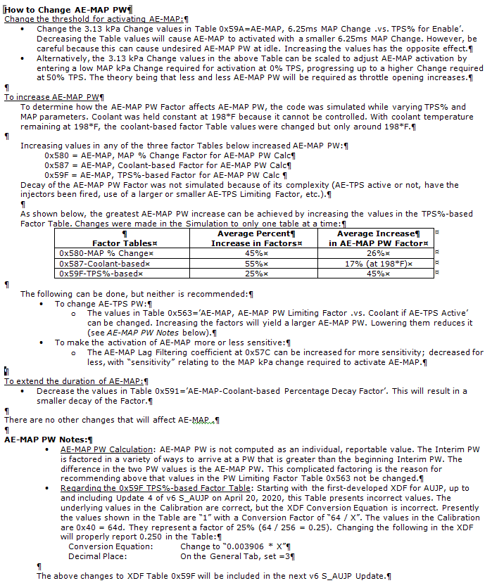

Yes, AE-TPS and AE-MAP lag filtering are similar.
But note, it's generally best to not change Lag Filtering Coefficients because they're designed for use in detection of subtle changes in engine states. These changes are then used to make important decisions. In the case of 0x57C, the difference in the old and new filtered values determines the degree of change in kPa. After many calculations, the invocation of AE-MAP may be affected but not always. It depends upon the calculated kPa differential. But the larger the filter coefficient the greater the new lag filtered value and thus the change.
The preferred way to affect AE-MAP is described below (from my AE-MAP document which will be republished soon):
