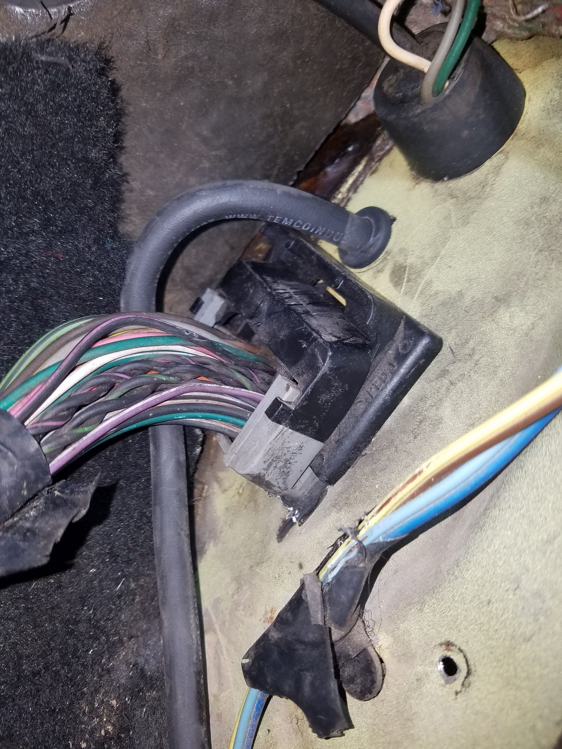

Engine is out and I'm knee-deep into converting from carb to TPI. Using an Innovate LM-1 kit and planning to mount the sensor in the tube that PO replaced the catalytic converter with. I was going to drill a hole sized to the cable and run a pass-thru near where the ECM wiring goes, but now see that the plug on the end of the cable won't allow a tight fit through a grommet.
How have others gone into the cabin?
Here are pics for a bit better description...
Plug that connects to the command module inside the cabin. Larger than the cable diameter.
Had planned to go through this area with a hole and grommet, similar to the amplifier power wire that is above the ECU plug.

I think I have an 8' cable. Spent this morning working on the wideband solution. I decided to go in through the HVAC grommet, had to slice it and remove a small chunk for the cable to go through and still allow the grommet to seat fully. Used a bit of spare silicone caulk to seal it back up.
Not sure if this route would be accessible with the engine in place, as it is pretty far down in there!
