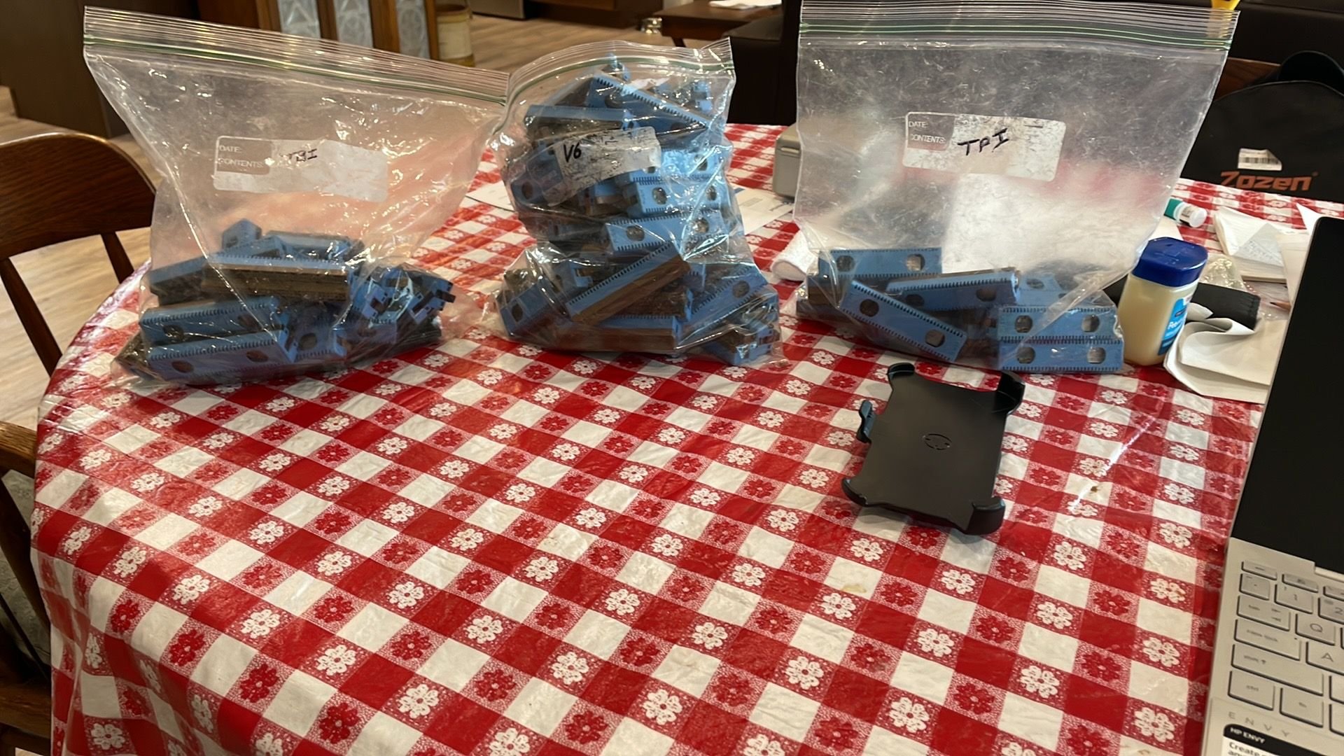

Amazingly enough I only have a 305 memcal but you should be able to find a 350 one on eBay for $50 or less
