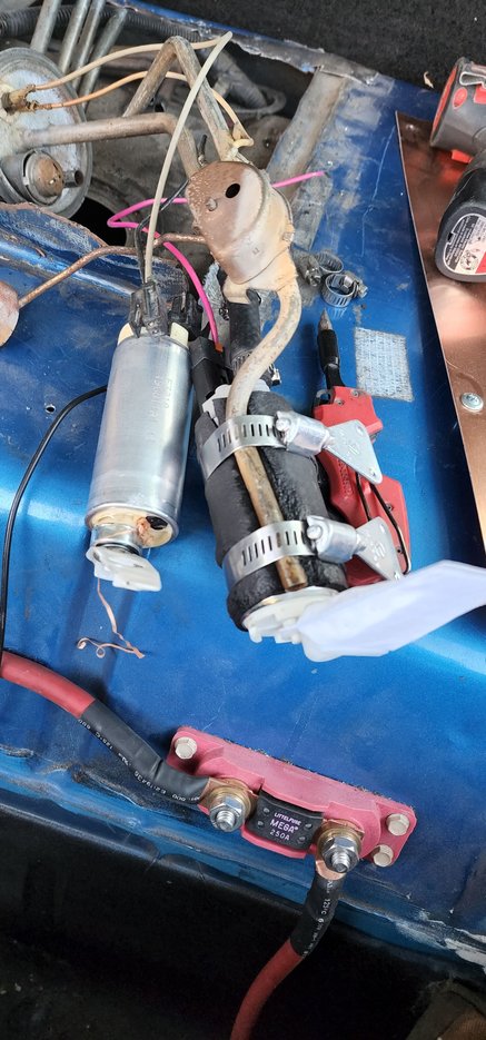

Fuel pump got here today and I installed it today. I'll post of photos of what was going on with the pump but I found ribbon on some type of entry hole on the pump. Everything on the pump fell off. The rings that held the pump in place fell of when I tried to removed the pump.I went a head and used hose clamps the hold the pump to the rod that goes down. I also removed the old connector and drilled it out to use a cable gland and pulled the new fuel pumps wires through and I also pulled the sender wire too. My next question is, does the stock wiring have a good enough power source to power my walbro? My battery is relocated to the back and its got a kill switch and all. So running the stock power source to a relay to than turn on the pump with a good connection to the battery. That a good plan? I'd just need a relay.

Went ahead and changed the pump out and the PSI on the pressure tester is jumping like crazy while the pump is on. Did I mix the wire for power to the pump and the sender? I tested it beforehand held a test light to the damn thing. Turned on the key on then turned off.

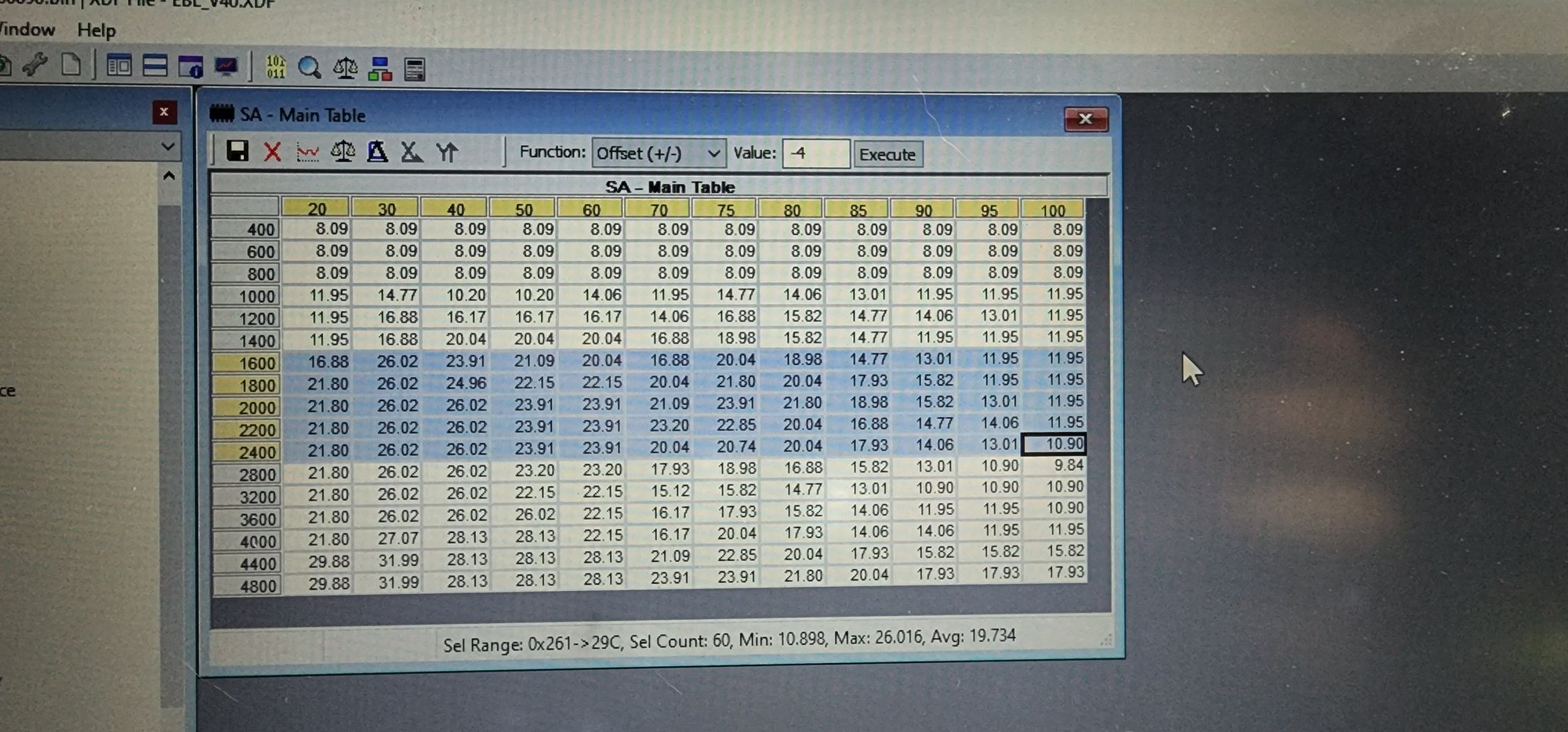

This is after a VE learn. Mostly cruise speeds in 4th gear and some on 3rd. Thiers no light throttle when driving. Its idle or 1500 rpm. Everything felt great under 2000
Here is my spark table. I think I see the problems. I'm a dummy but I think it's dropping timing when it gets to the higher KPA at that RPM. I used the stock LB9 table or the one suggested because of my iron heads.

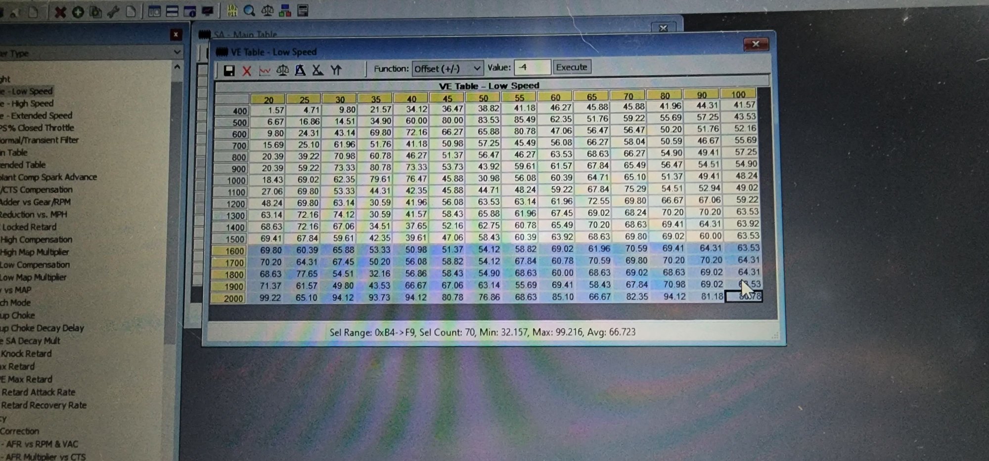

Here is my VE table with highlighted RPMs.
Not a god idea to second guess GM. At a minimum it shows a proper curve.
RBob.

So it looks good? I find it odd that as the car is actually moving up in the RPM under load that its going from the normal SA to dropping most of its timing. And the car isn't really under boost or anything. I'll have to do a data log and watch my MAP sensor while the car is moving. See where its at and what those spots look like.

I went ahead and removed more timing from the SA maps and its now moving past 2000 rpm. Wow. I got some learning to do. Ill look for a boosted SBC SA table so I can get a idea of what that looks like vs mine.

The timing is spot on. I don't know if I need to tear everything down but when timing is put to zero it reads zero on the balancer. Same with it moving to 8 or even 20s. I do have a problem with the timing jumping 3-4 degrees all the time. It doesn't stay steady at 8. If it moves on the WUD, its moving on the balancer.
​​​​​​I've also been messing with tunes and changing out my SA tables for OE ones for LB9s and the LO3. I did end up changing out my sparkplugs. Old ones were fouled. Lots of carbon. They've been hit with a lot of fuel. I changed them and changed the gap like my friend suggested. Dude told me to get around .20 I got them to around .25. Thing is now missing pretty hard and I can feel something smacking something. Jolts the whole car. Ill be redoing my sparkplugs and leaving the gap whatever it is.
Interesting side note. I went a head and used a 305 TPI idle SA and SA table for the most recent experiment tune and my o2 sensor would read lean all the time. Pretty sure I added fuel in some spots to. I then switched back to my boosted1.0 tune before most of this happened and the O2 was reading like normal.
I'm about ready to sell this thing.
Here's the tables compared to each other. Exptune vs the first one made with the turbos making boost.
