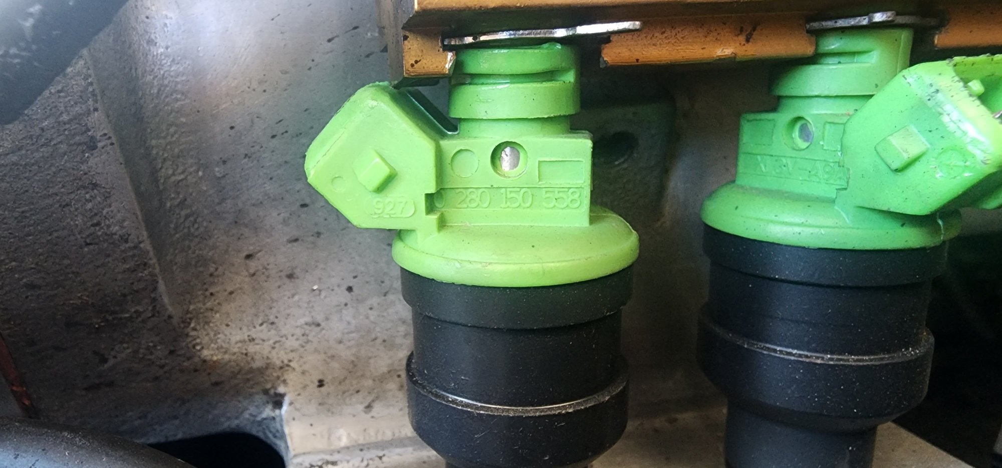

No data sheets. I got them off of eBay. EBay guy stated that they are 12ohms. If there is anyway to test that myself I should do that. It also said that the injectors were Bosch style injectors.

Re: Mini Ram EBL Flash
https://www.thirdgen.org/forums/diy-...ml#post6299624
Here's some info on those.
Might try updating your voltage offset tables with these....
