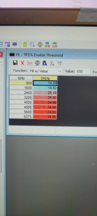

I've been working on an issue of running rich. I recorded a drive and noticed 2 things that don't seem right. Its always in open loop. could this be do to the rich condition? and its always in power enrichment mode. anything but idle it's in power enrichment. This is a new laptop and I'm starting over from scratch. What parameters do I need to change to correct this?

Check the PE enable versus TPS% & RPM table.
If so equipped, check the MAP & RPM table.
Even better yet, check the TPS% and MAP sensor values first.

During the drive at one point, tps was 20% and map was 55. rpm was about 1600. I saw before that these conditions are met here, but curious if this was the stock tune, since I never changed this. My thought would be tps at least 50% or more. I don't know why its staying in open loop, and which to address first

None of the provided four TPI BINs have those low TPS% values. Not sure what you are trying to say, copy the values over from a provided BIN...
RBob.
P.S. going through the other P4 BINs, none of them have values that low.

I'm not sure what happened here. I'm going through the bins and none of them have low values like that, except for the one that I used. I'm having an issue when I save a change, it says cannot write to change log file, but when I save to exit it saves. Sometimes the ve tables change when I reopen a bin as well. Maybe other things are changing too.
